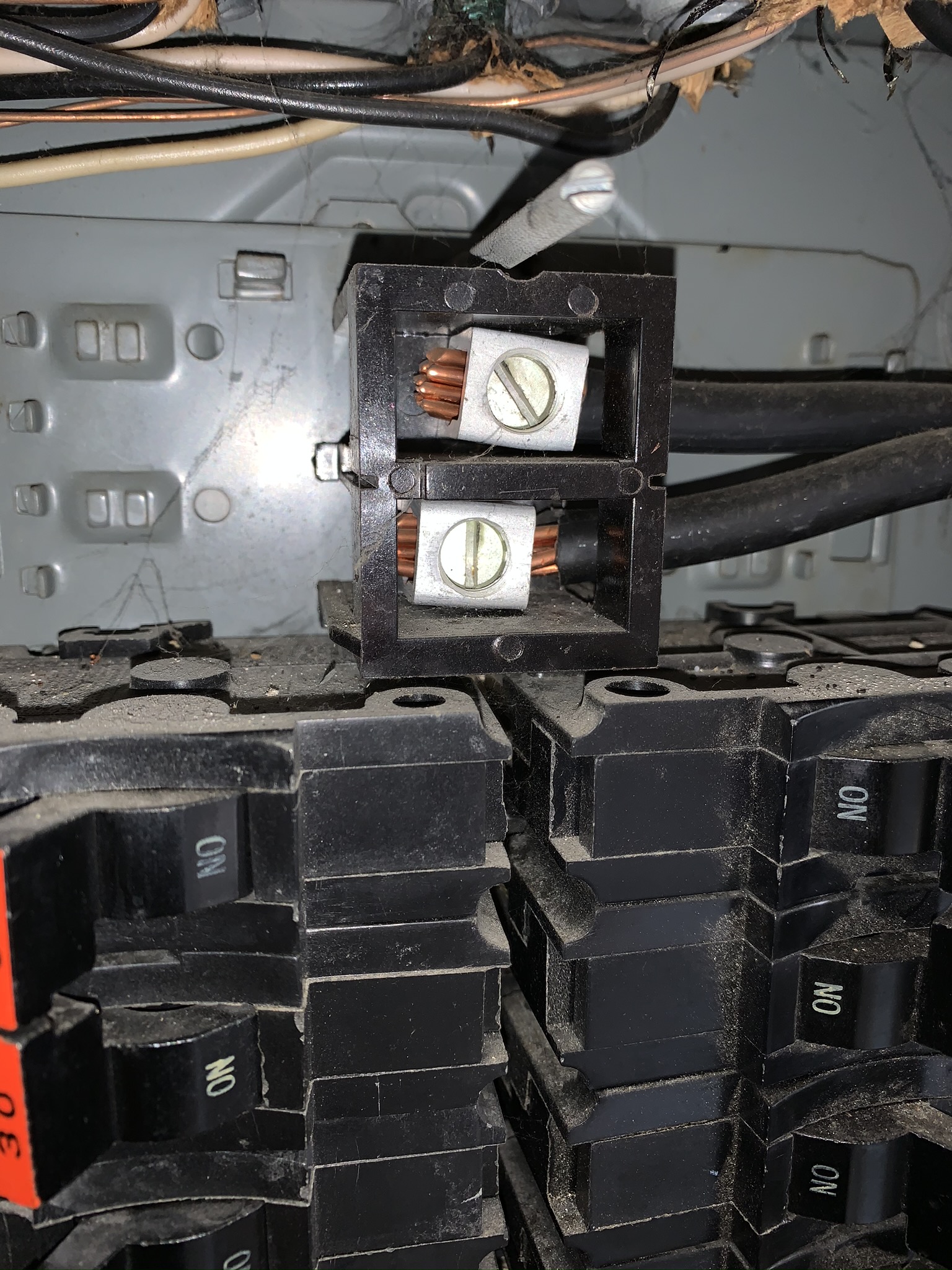

Came across a federal Pacific split bus panel. Not very familiar with split bus style. So basically is everything above the breaker with the yellow wires a main? How do you determine amperage? Thanks for any help with this
or any help with this.
I, typically, used the lesser of the SEC and panel board amperages.
Wire size (ampacity) of feeders.
Didnt see any visible markings on the main feed and I’m not very good at eyeing up larger size wires for size. Something I need to work on
Shit, I dont have any photos of that :thinking:
Well, don’t guess.
Example:
The service amperage was indeterminable but the service entrance conductors size suggest that it is ______ amps.
Or, ago back and get a pic of the panel board label. :smile:
Nah I wont guess. I’ll go back and pop the cover off, lesson learned
Why do you need to know this for a Home Inspection Report to have to go back and pull it apart again?

If not labeled, your guessing.

Anyone have a guess about the service size? Based on the service entrance conductors in the photo I would guess 100 amps.
Thanks Robert
Did you report on the fact that it’s a federal pacific panel? I know that it is not your question but what I’m getting at is the size of the sec is secondary in nature to the manufacture of the panel. Also wire size is not a 100% effective way to determine service size.
