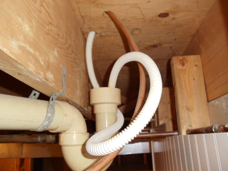

Is this allowed for a dishwasher drain? It certainly looks funny, but don’t want to call it out if there is nothing wrong with it. I don’t think the end was even attached to the pipe.
No…it’s wrong…
That’s not a kitchen sink trap.
P2706.3 Prohibited waste receptors. Plumbing fixtures that
are used for washing or bathing shall not be used to receive the
discharge of indirect waste piping.
Exceptions:
- A kitchen sink trap is acceptable for use as a receptor
for a dishwasher. - A laundry tray is acceptable for use as a receptor for a
clothes washing machine.
Diy standpipe.
WTF! No was it that good. What’s preventing that from coming out? Can you imagine what would happen if there was a blockage down line and everything started coming out that p-trap? Your right in thinking that’s wrong. Time for a plumber.

Well of course its wrong, its obvious that the P-trap is up side down…lol

That is wrong in so many ways… before it gets to the trap.

No ! Totally not acceptable "
and remember dont try to fix the problem " but definitely note in your report .
