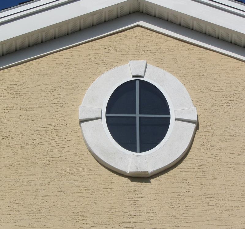

False/decorative window in the peak of a home, behind the window is a false wall inside of the attic. Should this be protected? Does this qualify as X per the wind mitigation form, or would you mark A?
The first window, no, as it doesn’t appear to be part of a living space.
The second one, no, because,if my eyes are correct, I see the wood siding under it so it isn’t a window.
#1 The first glazed window on the upper porch does not since it’s breakage will not result in water intrusion into the dwelling. #2 The second glazed window (even though it only opens into the attic) must be hurricane protected since if it is broken it will result in water intrusion in the attic and may allow the wind to compromise the roofs structural integrity.
Water intrusion is secondary to pressurization of the structure in all respects. I agree with your assessment of the requirements for coverage. This was intended not as a criticism, a clarification.
