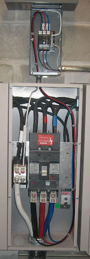

No personal pics but here is one from another HI forum,
There is no image, Jim, simply the red “X” box…
Here’s a 10’ tap rule compliant installation. 400 amp feeder, #6 tap conductors (minimum 10% of feeder ampacity) to 15 amp circuit breaker. The lugs on the bottom accept two conductors (double lugs) in the #6 AWG to 500 kcmil range:

Do the lugs at the top, that are hidden, have a similar design accepting two conductors?
Yes, the load portion of the switch (top lugs) is factory wiring for a dimming system. The bottom portion is the feeder connection.

I’ve always considered the above picture by Mr. Meier as incorrect due to the fact that you have a larger conductor and a small conductor tied together. The problem arising from the fact that the smaller conductor could be subject to more amps than it is rated for. That must not be the case then?
Kenny
The OCPD limits the current that can be drawn through the conductors. Current is not “pushed” from the transformer.
Is the lug on the left triple taped or am I seeing a shadow?
Okay, so in the picture that Mr. Meier posted, the breaker in the top distribution panel would protect the 6 guage conductor from having too many amps drawn through it, right?
So as long as there is an OCPD down stream, conductors of differing sizes can be tapped together…pending the lug was designed for the multiple taps?
Of course, and I’m sorry to have to ask, is there a way to easily determine whether or not a lug is designed for taps or not?
Kenny
Kenny, read 240.21 to better understand the tap rules. The OCP is provided downstream from the tap connection.
Unless listed for use with multiple conductors, just assume that the lugs are only listed for use with one conductor.
