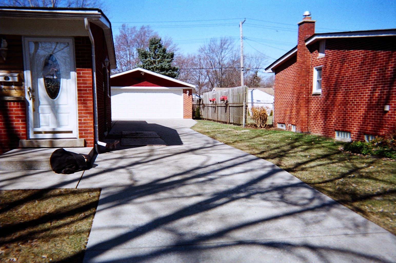

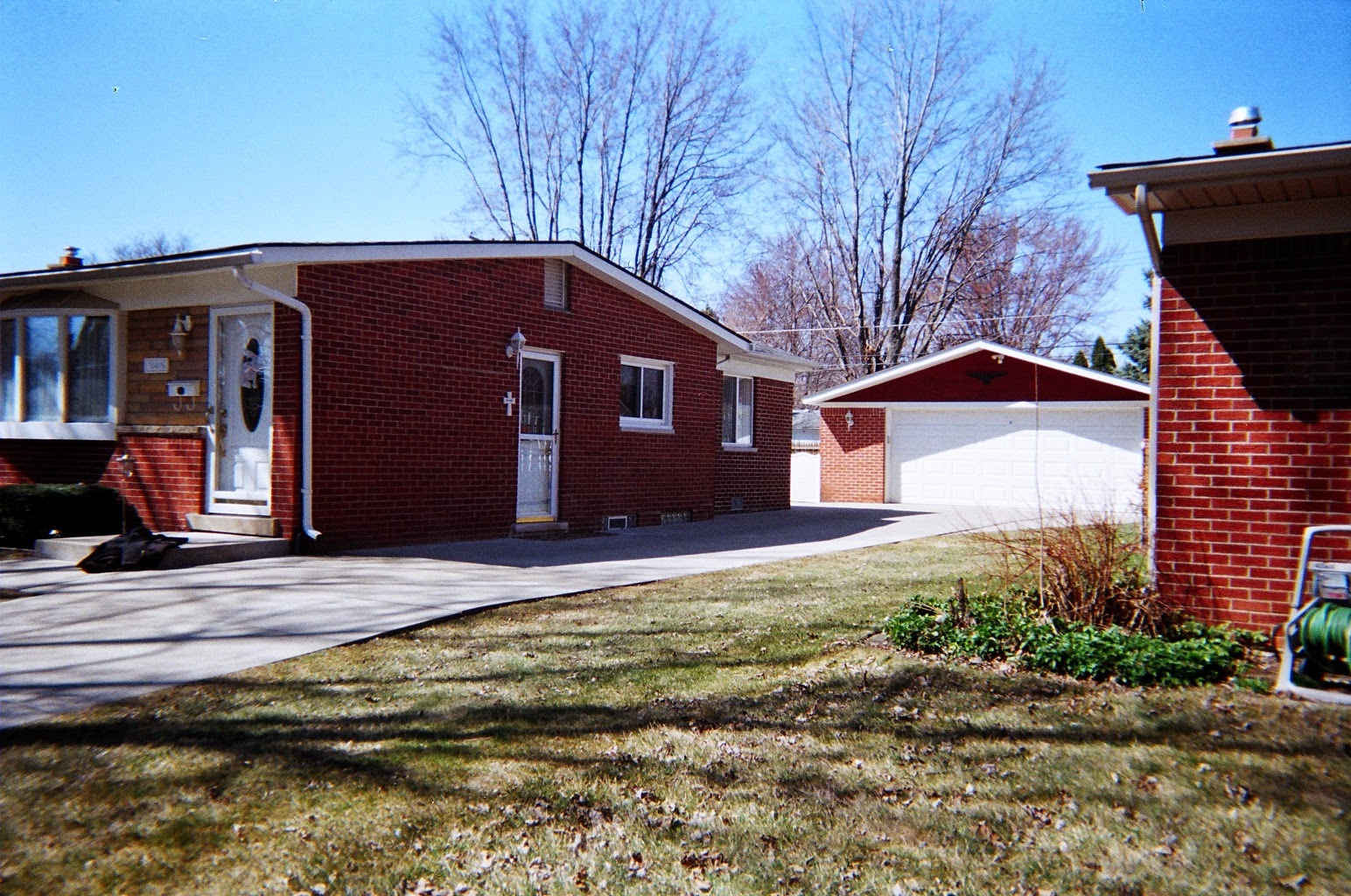

Driveway installed too HIGH, that's right, plus they used rebar into house lol
St Clair Shores, poured foundation walls, basement leaks under SIDE door UP HIGH, yeah water runs down the poured wall from waaay lol up high… and oh, is the pitch aka GRADE of the driveway slabs sloped away? hahaha Hell yeah baby, they sure are! So why on earth didn’t the new-better-pitched slabs SOLVE the leaky basement? Duuuuuuuuuuuuuuuh!

From my computer, assuming the building bricks are level, it Does look like the driveway slopes into the home, at least from here. I could be wrong. Point source of water (downspout) in the general area can’t help, as it creates a higher water area while raining. Can’t see the back side to see if water is flowing from the back of the home to the front.
I always found it useful to view problem water intrusion areas while it was raining.

1: Masonry to close to grade; unless it is a brick foundation.
2: Hardscaping should be able to move independently.
3: Hardscaping require to be ‘sealed at the foundation.’
4: Basement window, if a means of egress, is not compliant.
I have never see a basement window well on a driveway side.
Seal the opening or provide a means of egress.
I would have cut the bar steel with a sawzall, sealed the hardscaping at the foundation and recommended sealing the opening. Cheaper.

Brick too close to grade.
No wall flashing.
$16,000 was not expense for the size of that driveway, walkway steps and landing.
Easy correction by the way.
Plus I do not install window well egress on driveway sides.

Marcel. In this video, one of many provided by the OP on the wrong component, hardscaping, a path/walkway, abuts a foundation.
My report would read, Observation: Heavy impervious material too close to the foundation.
