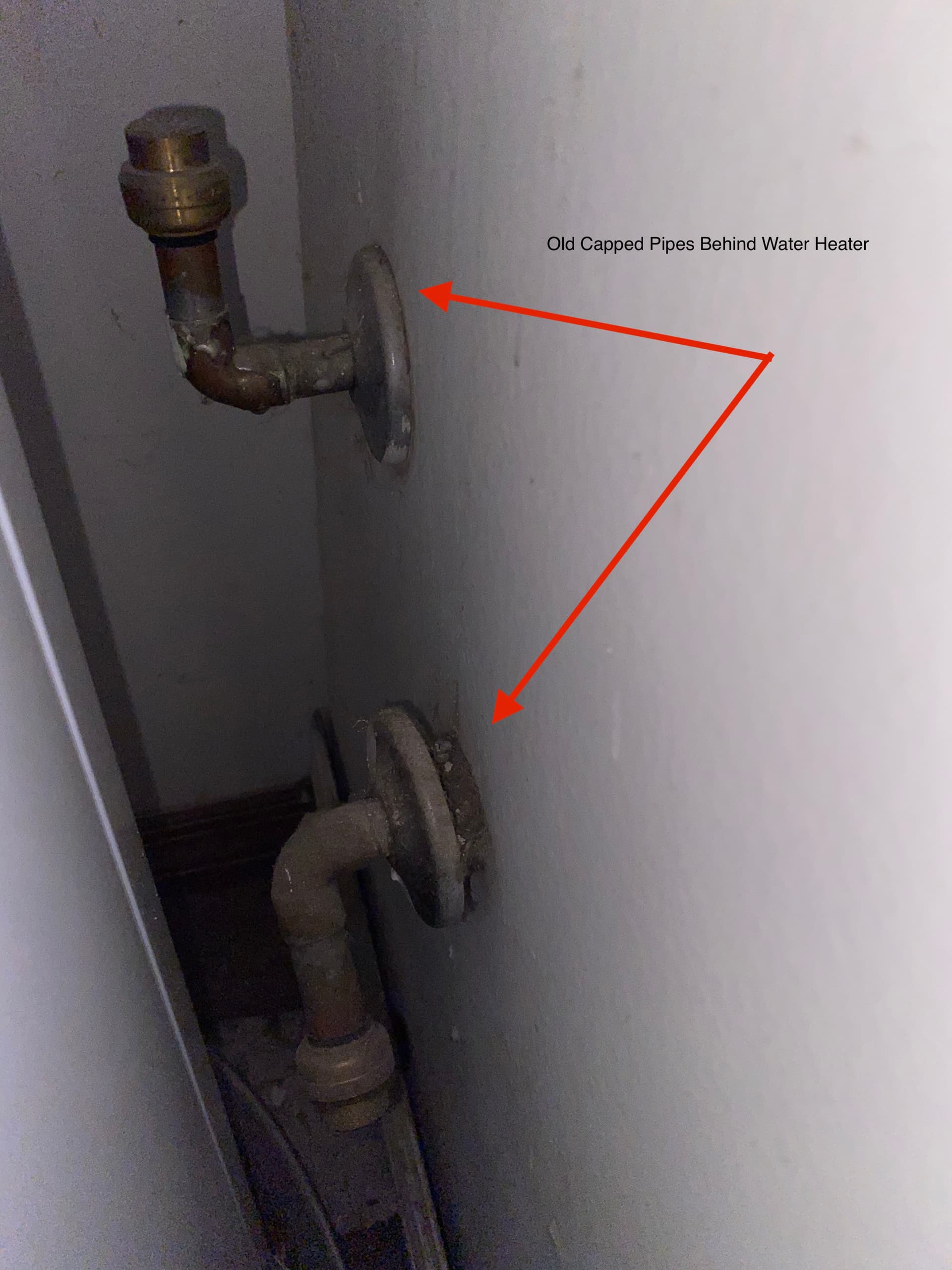

I am working on my pre-licensing classes for Florida and have a question about the picture here. This is a picture of the water heater in my house. It is electric and the plumbing system is PEX. My question is, what is the topmost pipe, coming from the top of the cold water supply pipe? It goes into the wall, wiggles a little, but seems to be secured to something.

Hi everyone,
Thanks for all the great insight. I can tell I have chosen a great group of people to be affiliated with. I have been checking into the mystery in my OP. I checked my attic and bathrooms for a recirculation pump and found nothing. No sign of an expansion tank anywhere either. My real mystery is the seemingly extra cold water pipe running into the wall.
I have included some photos with labels if anyone wants to have a look and chime in again. Luckily, this is my house. I would hate to have to stand in front of a client and be totally clueless as to what is going on here.
Thanks!
