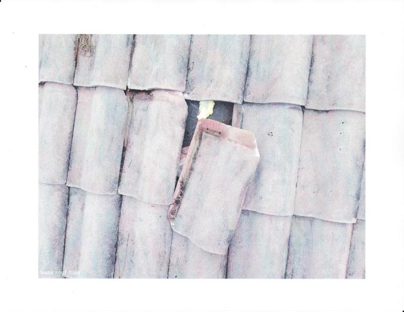

Don’t forget in Florida, older cement tiled roofs pre-1994 may have been secured with cement, not a nail down system.
You cannot tell very well if there are loose tiles without getting up there.
