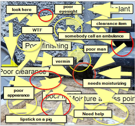

What type of EFIS? Drainage or Barrier? Looks like barrier.
Moldings belong on fenestrations.
From my view:
1: overall poor EFIS clearance.
2: Gaps. The lower threshold component was not finished and made water tight.
3:
Unfinished trim.
