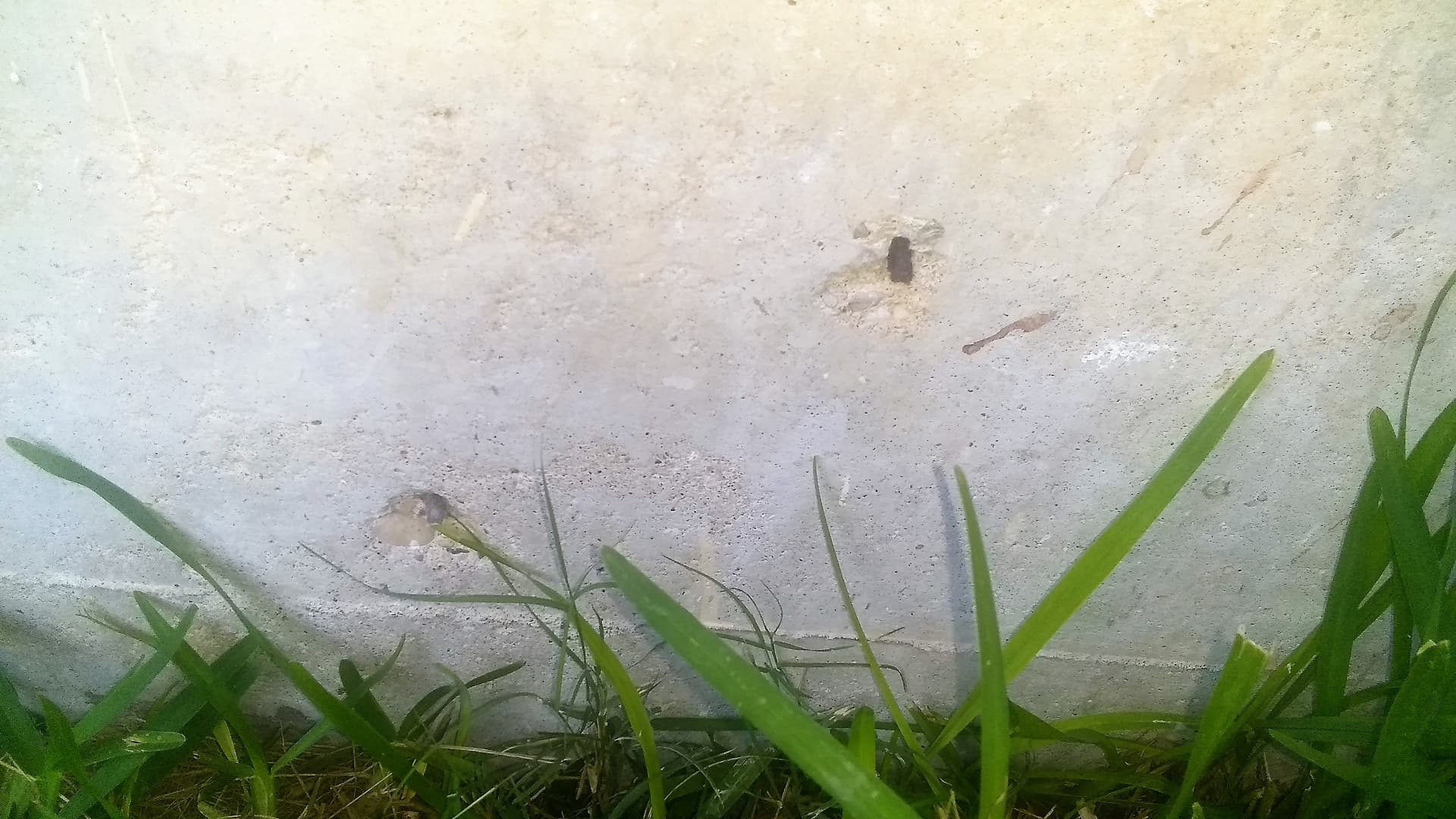

Hi all. The pics attached are a pier and beam foundation with concrete perimeter. Can someone tell me how this would be repaired? There’s also what look like rusty nails along the foundation, though they’re not sharp. Can anyone tell what these are for? Thanks for any replies!
  1. Looks like a nail
  2. Looks like rebar which is a concern being exposed and rusted.
The “rusty nails” are form ties. They are a what are used to hold the concrete forms in place while the concrete is being poured. After the forms are removed, those ties are snapped off flush with the concrete. If not covered with paint, some form of damp proofing, or parge coating, they will rust when left exposed to the elements since they are steel. Those ties need to be covered and/or protected from the elements.

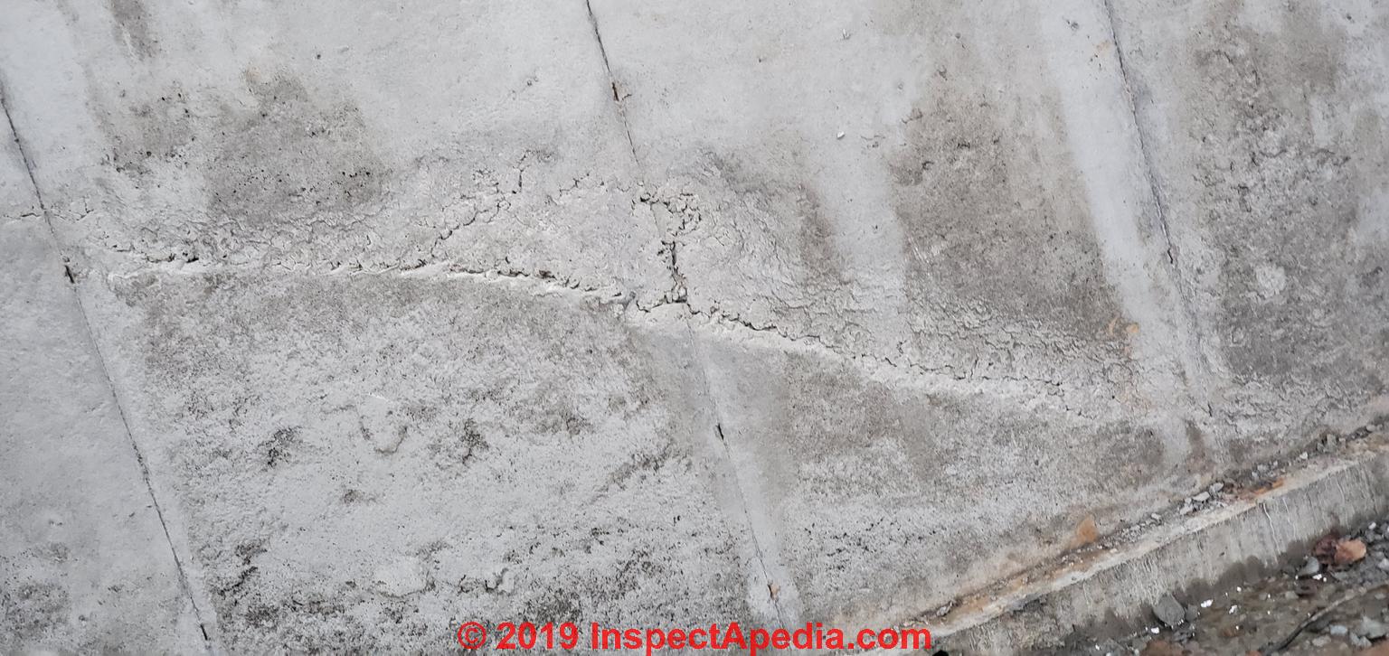

Not necessarily. There are at least 3 in this picture, hard to see but they are there:
This was obviously from a commercial job where more than likely a vibrator was used, consolidating the concrete where the different lifts were poured, making the joint hard to see.
Here’s another example from InspectApedia (I added the arrows and text):
Cover this with some damp proofing or paint and nobody would be the wiser. Give it 40+ years exposed to the elements and a different story could be told…
Another example. I took this one myself while waiting to deliver a load. The only way to know it’s there is the color differential. Different loads poured at different slumps (the lower area was poured at a higher slump, or considerably wetter), with some gap between them being placed…
