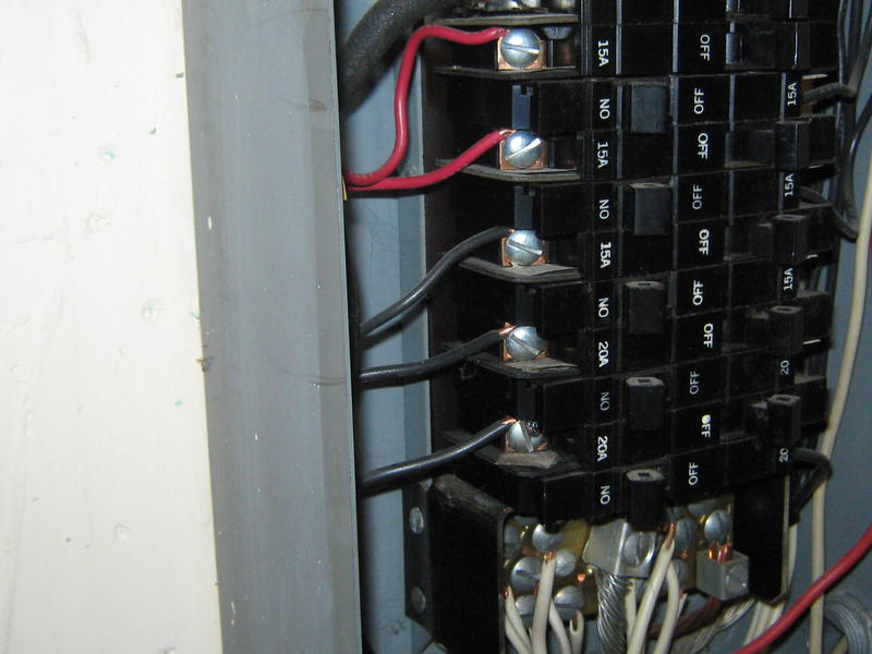

Pics of the panel… Thanks everyone. Let me know if you see anything else. No manufacture data and no indication on the main breaker. My educated guess was corrected by a good friend to 100-125AMP MAX split buss panel. Manufacture is Cutler Hammer.

10 (?) gauge wire connected to the main bus looks like a problem to me.
Triple tap at feeds, Open knock out at base of panel. Upper right corner of the panel buss… I see 30 Amp but can’t make out what that is all about. Wire sizing maybe wrong there…
Opening in the bottom of pic 1. Looks like a double tapped breaker in pic 3. Exposed romex should be in conduit in pic. 1. Where are the grounds?
Shouldn’t the cables feeding the lower bus be protected from the sharp edges of the cabinet?

– Panel is only grounded to earth. The entire home has no GFCI or three prong outlets.
– Where do you see exposed Romex? Guess I’m missing it.
– Not sure i see the sharp edges your talking about either.
– Triple tap at feeds — agreed
– Open knock out at base — agreed
– 30 AMP I saw no problems. I can’t remember exactly however it was for the furnace if I recall right could be wrong.
Ralph you talking about the red wire? If so I wonder why its there as well. Any idea?
The 10 or 12 guage red and white wires on the right side and the black wire on the left side are all under rated. They may have no over current protection at all. Somebody must have thought it was OK to connect a circuit there for some reason. I don’t know why they wouldn’t have just double tapped onto an existing breaker (not that double tapping is necessarly OK, but at least the circuit would have over current protection).
Off to the right side of photo 1, it look like a small sub-panel with romex wiring coming out of the top of it. As a general rule of thumb, it should be protected from potential damage, which means behind walls or in conduit.
The cables at the lower main lugs (top part of the panel) bend over a metal tab that is unprotected by a bushing.
