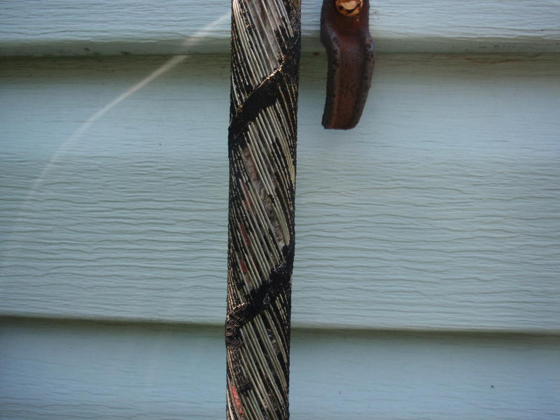

I wrote this service cable up as being defective due to the worn sheathing. I have written it up before and the people have replaced the cable. Today the homeowner had the electrician call me and chew me out for writing it up because it would cost the homeowner a lot of money to repair. He said that the frayed wires are the ground wires and it was okay that they were exposed to the weather. I have had electricians say that it is unnacceptable and should be replaced. Now the homeowner and realtor are upset with me. I feel that it is not water tight and should be corrected. Can anybody give me the right answer?
That cable has reached the end of its service life. It could also allow water into the socket or panel. It should not be a lot of money to replace.

He shouldn’t call himself an electrician.
As Jim said this cable definitely needs to be replaced.

I would not give the guy credit for even being called an electrician. It’s people like him (lack of proper training) that continue to cause people to get electrocuted and or causing electrical fires. That picture is basic electric 101. What year is this 2011?
Well at least he was close, since thats the “grounded conductor” on the service side … :wink: … but that usually carries current … :shock:
[The chances that the loads to each of the service hot wires are perfectly balanced to completely cancel each other out is zero to none]
