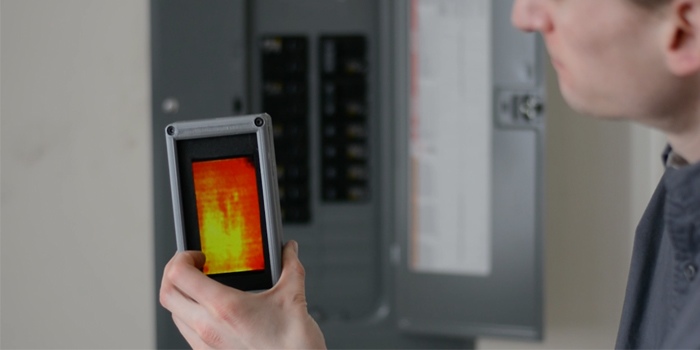

I’m just curious what professionals’ feedback on this newly-announced product campaign is:
Fun for homeowners. Not close to a professional tool.
Thermography if used to find anomalies requires good equipment and the skill to “read” your images and this is not a camera a thermographer would show up on a jobsite with. Other than that looks pretty cool.

Shutterless 82x62 thermal diode imaging array This is part of the problem!! Well below minimum acceptable resolution requirements.
5 megapixel CMOS image sensor It has a 5 megapixel image sensor but only 5084 points of actual data from imaging array. Sounds impressive, but the actual results are still the same.
Good material to place in stocking of your teenager at Christmas… although they may not even think it is cool.
Ah you are too hard on it… I think it has three colors!! What in the world is one supposed to get out of that image. I would be embarrassed to own one.
Another camera for people who find the cost of a real IR camera prohibitive. This type of tool does more harm than good as it is being marketed as a diagnostic tool and its far from that.

Hey guys, I’m the guy behind it, I’d be happy to talk about image quality or tasks or anything. I realize that many professionals really need that higher resolution. This is a more affordable option that beats anything under $1,000. In fact, there are professional imagers around $1,500 that have the same resolution as ours but because their sensitivity is so bad, the images are not as good as ours. What makes this one useful is the image sensitivity which allows for improved detectability. Higher resolution (as long as sensitivity is not compromised) will improve detectability, but it comes at a large up-front cost, which keeps a lot of people out of the thermal imaging market.
