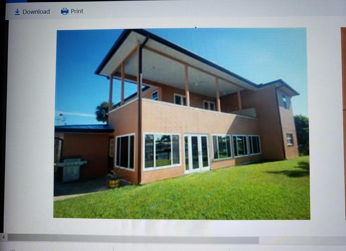

Would you consider the first story flat roof as part of the hip/gable credit even though another roof is above? Trying to determine if its hip or gable and the rest of the building is hip.
Why must you be so specific. I would simply describe the roof type as “hip and gable”. Period. Move on.
Looks like other to me.
Try posting in the Florida section.
Joe he’s asking about a wind mitigation insurance report…
looks like the flat is tied into main so it “LOOKS” like a other from what I see.
Yes I was just referring to the wind mitigation but, you can still be specific and not call it both lol. On our wind mit we called it other and the questioned so we provided the math but he said that was not the roof for the first story building. We informed him that since that second story was open we had to consider the first story flat roof. Thanks again people
