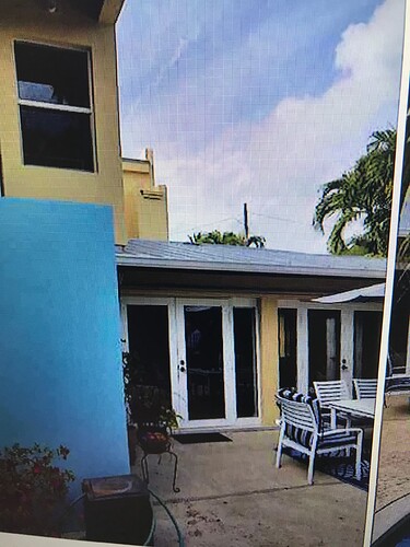

Had a question from a buddy who is also an inspector. He inspected a home, and the home had a few flat roof portions and a few hip roof portions. How would this be marked on a wind mitigation form? Other? Would be a shame to mark other when the features are hip and flat. I know we always go weakest form of protection, but would it be float iff a majority of the features are flat?
10%. Get the building measurements off the county appraisers site. Measure the bits non HIP.
That Square flat section is likely to be more than 10% unless there is a huge roof section I cant see.
You’re there (or your buddy is there) to verify how it was constructed, not hand out credits. Stick to the form and answer as instructed.
I know my role as an inspector i guess you missed the point of the question. If you have equal hip and equal flat sections (something i haven’t come across) we both considered the fact that the roof would perform the same as a hip and flat roof so why wouldn’t the homeowner get some sort of credit for that. The insurance broker had a hard time with this one as well.
