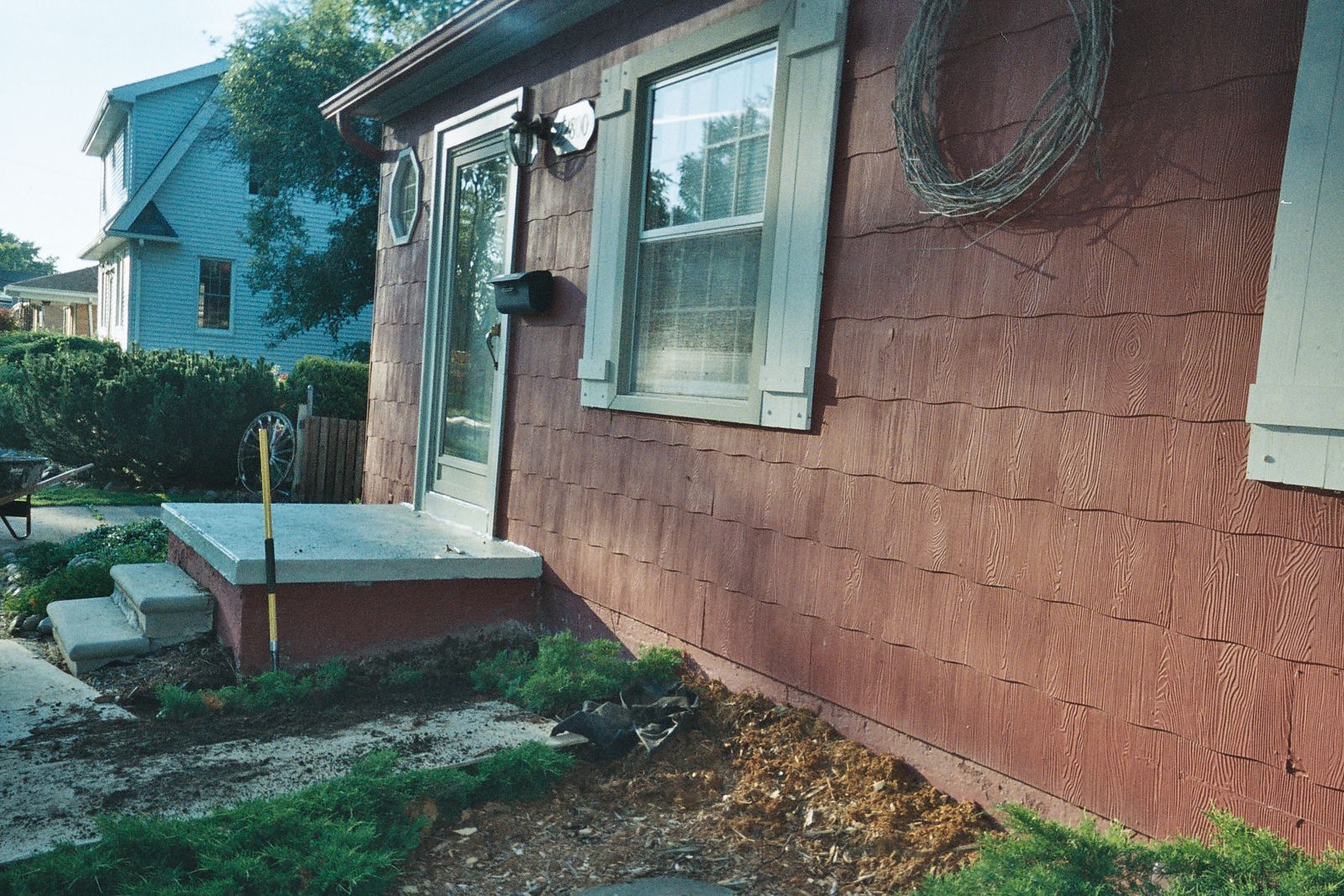

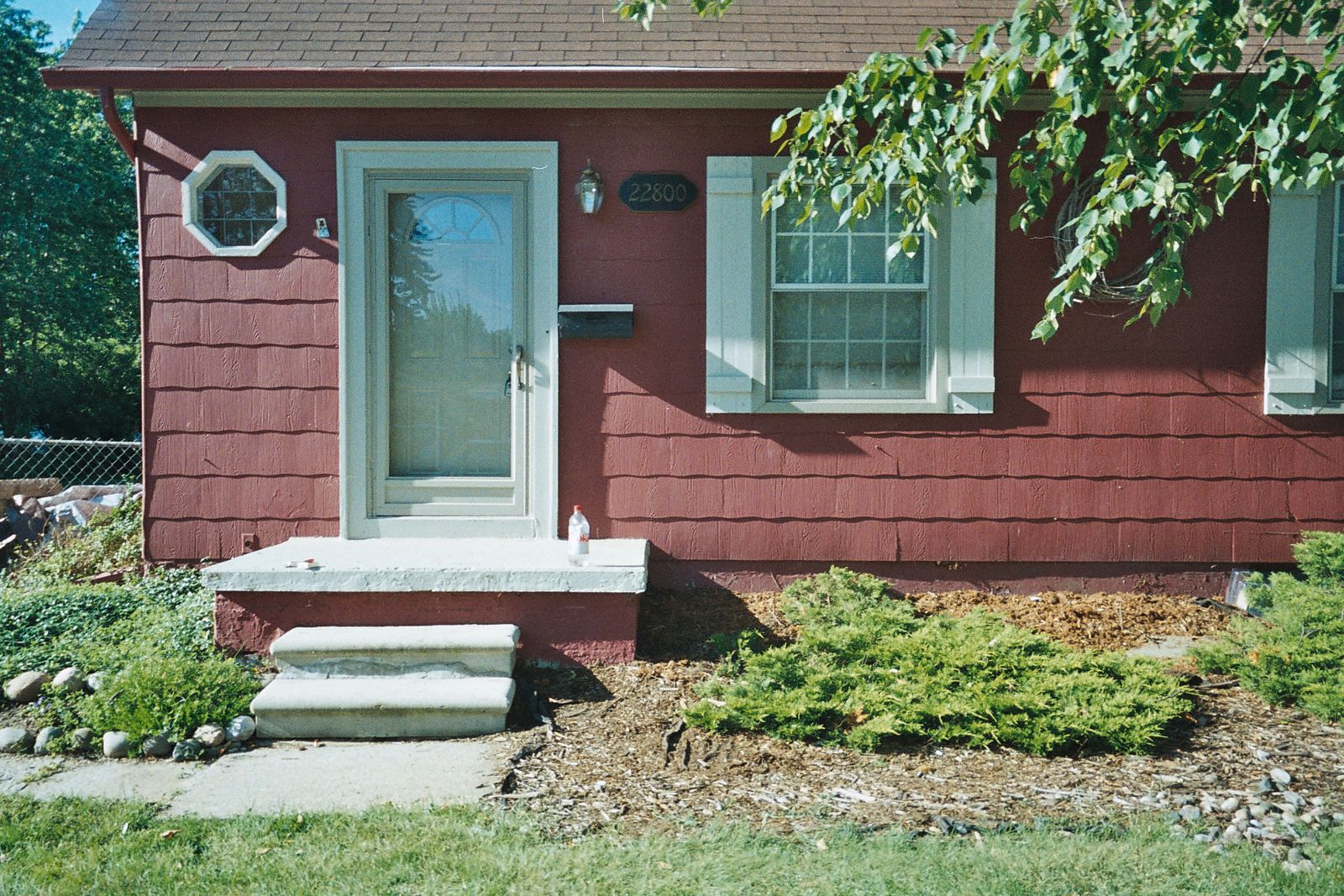

House 4 Sale, homeowners previously hired Niwit & Nitwit waterproofing

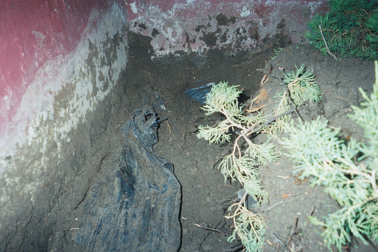

that’s right, there are exterior morons as well or, DIYers etc, well Mr Niwwit and son here backfilled with the same clay soil n did not use any hydraulic cement in/over crack so it kept water out for about 1 year lol. The clay soil they backfilled with settled and as it settled it pulled own the top 1’ or so of the tar that was applied and the top of visqueen as you can see in photos, WASTE of money! YOU think your saving a few hundred when, obviously your not.
also note the GRADE, is the grade raised and sloped away enough for you? And why didn’t this raised grade keep water out? hellloo!
the RIGHT side of porch is where they leak, was always where they leaked they said
see the top 1’ or so of the tar and visqueen? lol
see Marky’s pretty little scraper?
see any exterior opening where water was getting in? lolol
done.
please do tell, what good would an interior drainage system and 29 sump pumps have done to STOP further water penetration? And at what cost $ ?
== SCAM!
The exterior crack was not visible from inside the basement, this means lol when you looked at the block walls, where they meet inside there was NO crack, nada, you’d only see water that came in where the bottom of the foundation wall meets the basement floor.
