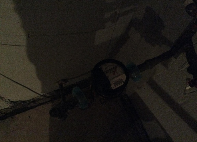

This is a photo of the water main in the basement. The meter is where the potable water passes through and into the house. It’s important to advise the client as to where this is and also where the main shutoff valve is in the home. This can be very helpful in the event of an emergency pipe break or other water leaking from pipes.

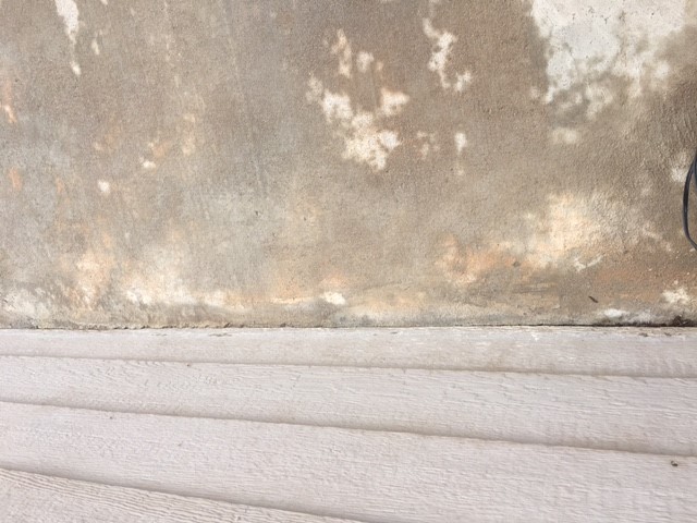

While Inspecting this house, I noticed many issue with the siding and surrounding areas for runoff and downspout maintenance issues.
In looking at the siding requirements, I noticed that when an addition to the concrete slab in the back was performed, the concrete was poured higher than the siding lower end. As such, this concrete is moving and causing issues with the siding.
This will cause issues in the future and must be corrected.
