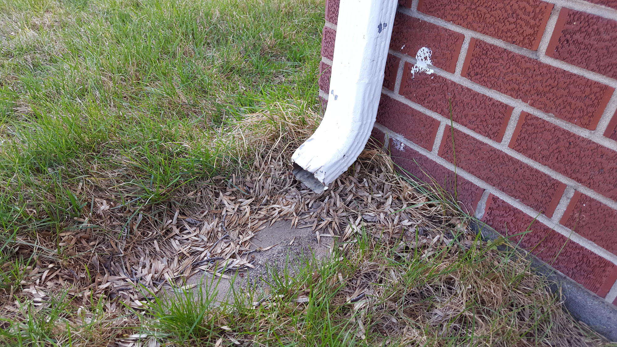

During a home inspection I identified this downspout. The standard is that the downspouts will discharge 4’-6’ from the structure. This particular downspout discharges only 18” from the home. This is a concern as the water discharging from the downspout can increase the groundwater to a point that it can eventually damage the foundation. This issue was flagged with a suggestion of having a professional extend the downspout to meet the 4’-6’ standard.
