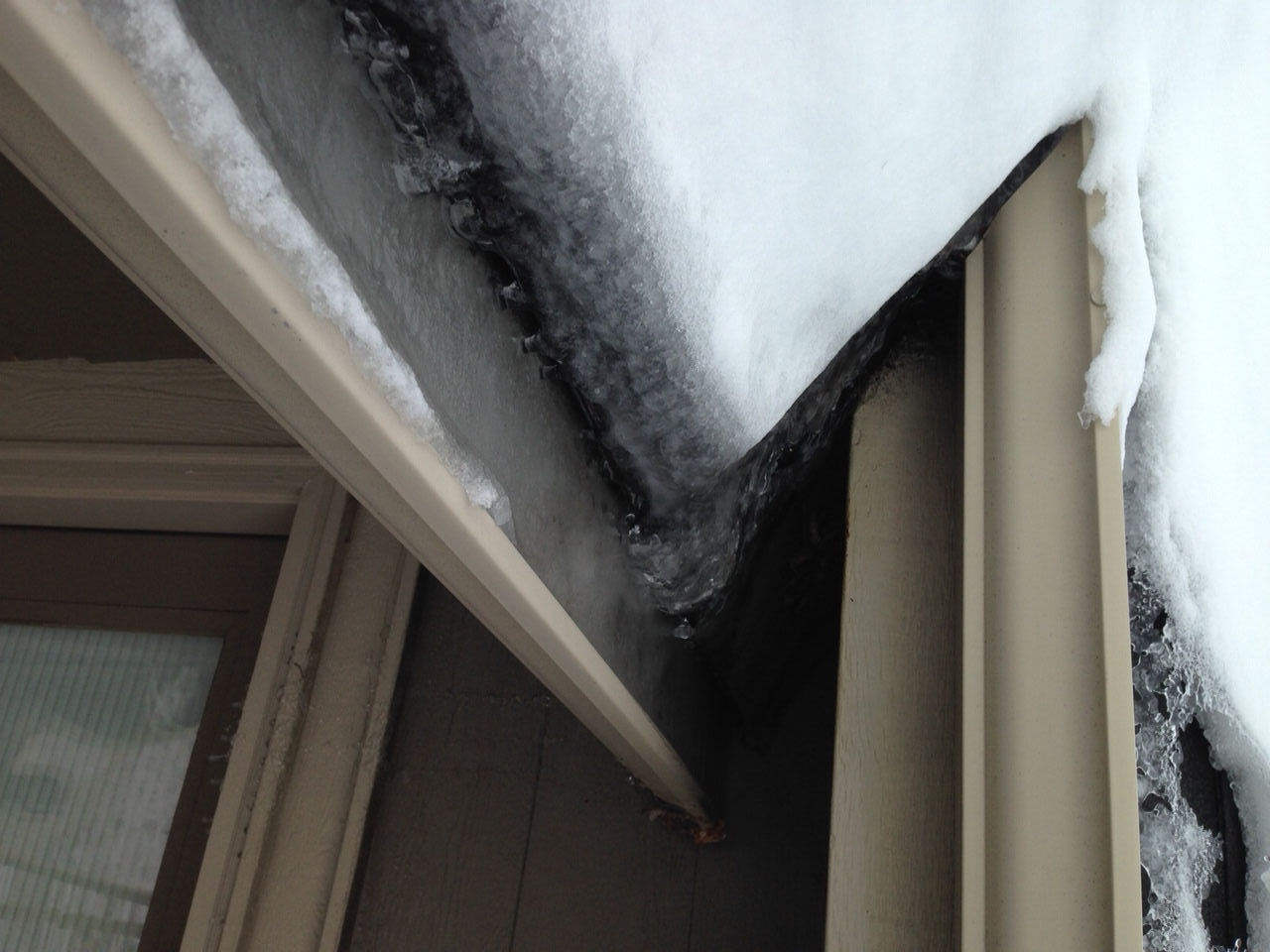

These pictures show excessive ice buildup in the gutters on the north facing side
of the roof. Since this buildup is only in the gutters, this does not appear to be related to an issue with the roof insulation where excessive heat would be causing ice to form on the roof.
This buildup was present after several weeks of consistently cold temperatures below freezing, and so the likely cause of this is the water freezing as it hits the cold metal gutter before it can drain out.
There are two fundamental concerns with this buildup. The first is that water is dripping directly onto the house and door. The second is that the gutters are not designed or constructed to support this much weight and thus they could break away from the roof.
This has to be addressed immediately to remove this extra weight. As a longer term solution, heat tape could be applied to the bottom of the gutters to minimize the ice buildup.
