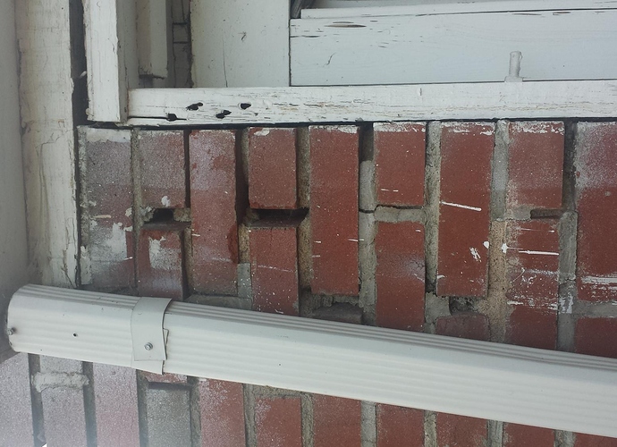

These pictures were taken on the exterior wall of my rental home in Denver,CO. As you can see these masonry walls need to be re-pointed. There is significant space between the bricks. There is also some efflorescence on the back wall near the gutters due to heavy leaking from the detached downspout. I would report this and recommend a professional come check it out.
