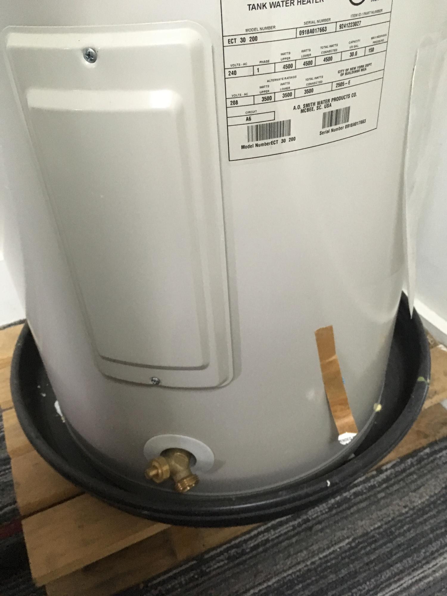

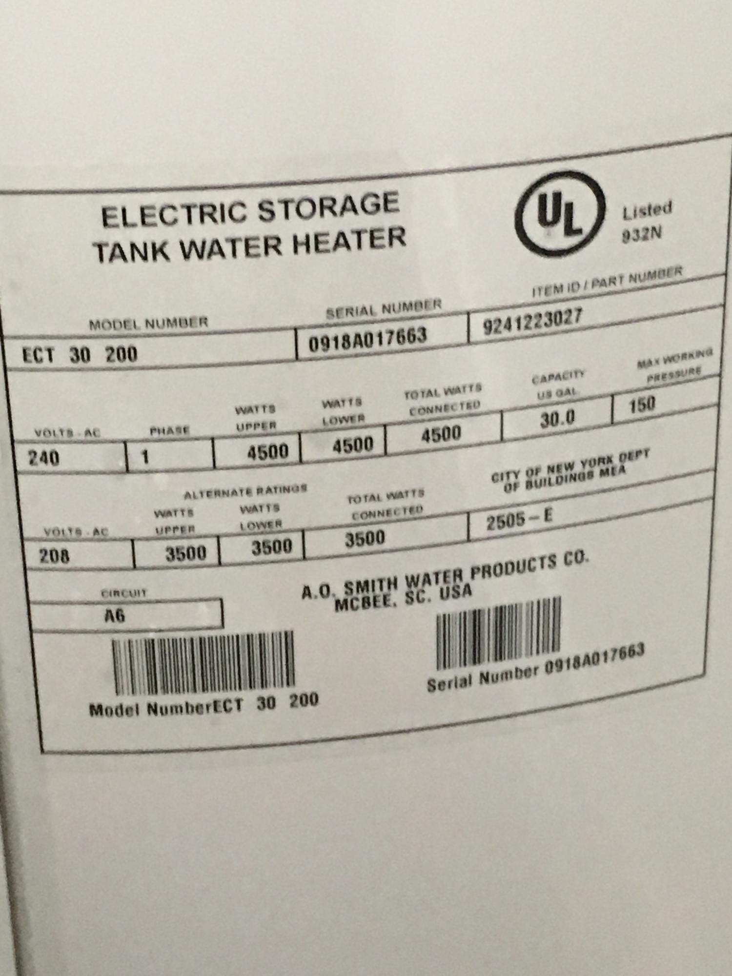

This water heater is an A.O.Smith 30 gallon electric water heater manufactured in May of 2009. It has been powered on dedicated 30 Amp breaker from the panel box just left of the location. The green grounding screw was not present. All piping was done in cpvc with a hot water shut off valve installed. The temp/pressure relief valve is present and piped down to the catch pan under heater with an air gap, then piped outdoors from pan. The drain valve is present and made of higher quality brass. There were no leaks, water marks, rust, or other physical damage noted at time of inspection. Recommend some type of retaining strapping to prevent possible tipping and proper grounding of water heater tank.
For this trip to the library of articles I choose to look at the water heater InterNACHI Water Heater Dating Chart. Although there wasn’t an article to read in this one, the chart will prove itself quite useful in determining the manufacture dates. In the videos the speakers have mentioned a few times how the date was hidden in the code on the information plate/ sticker, but I still wasn’t able to see it. Think I was looking for something a little less cryptic. Now armed with this handy breakdown of their coded messages I too can now spot the dates in the Water Heater Matrix.
