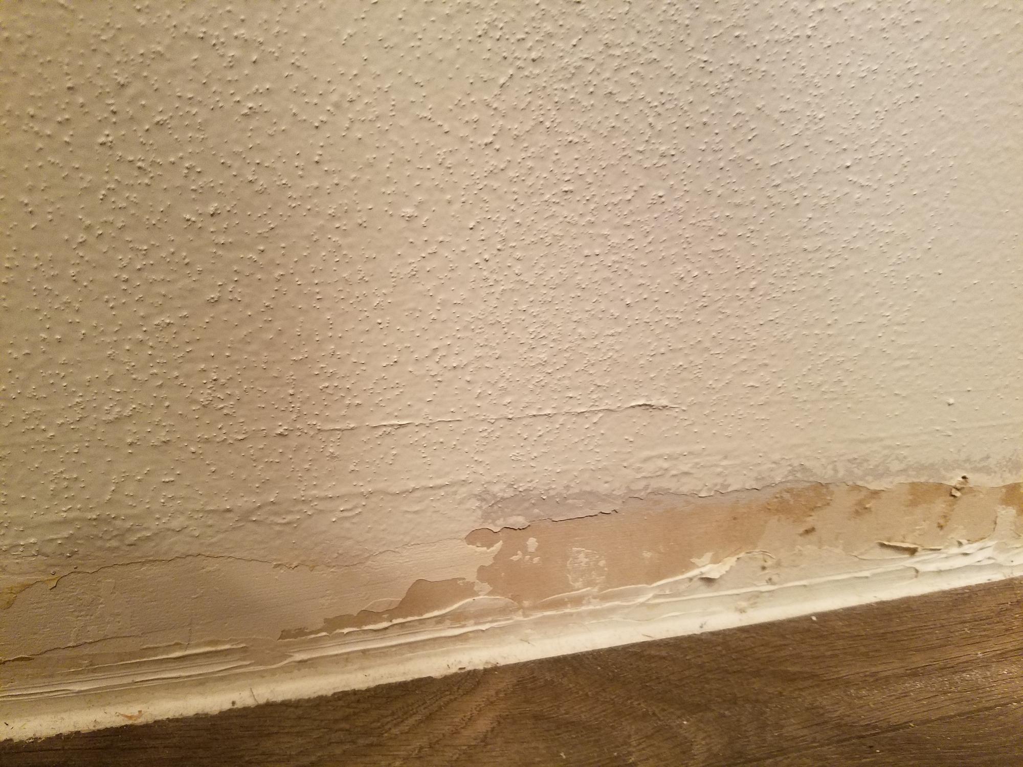

Water damage had occurred to this bathroom recently so all of the base was removed and thoroughly dried for 48 hours to help prevent mold from growing on the gypsum. As seen here the drywall is completely dry and there are no visual signs of mold.
