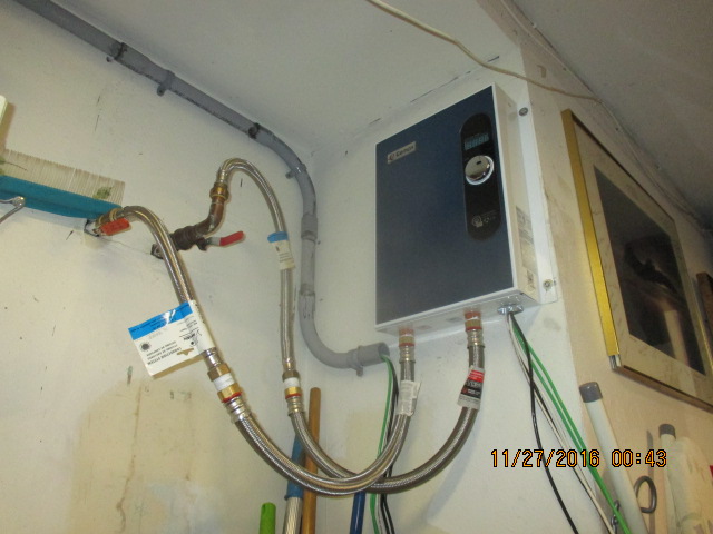

This is a an installed tankless water heater that has some defects, The electric wiring is hanging loose and not protected in conduit. The water lines are hanging loose and need to be secured to the wall. There is no TPR valve, however the manufacturer’s installation instructions state that a TPR valve is not required.IMG_7678.JPG

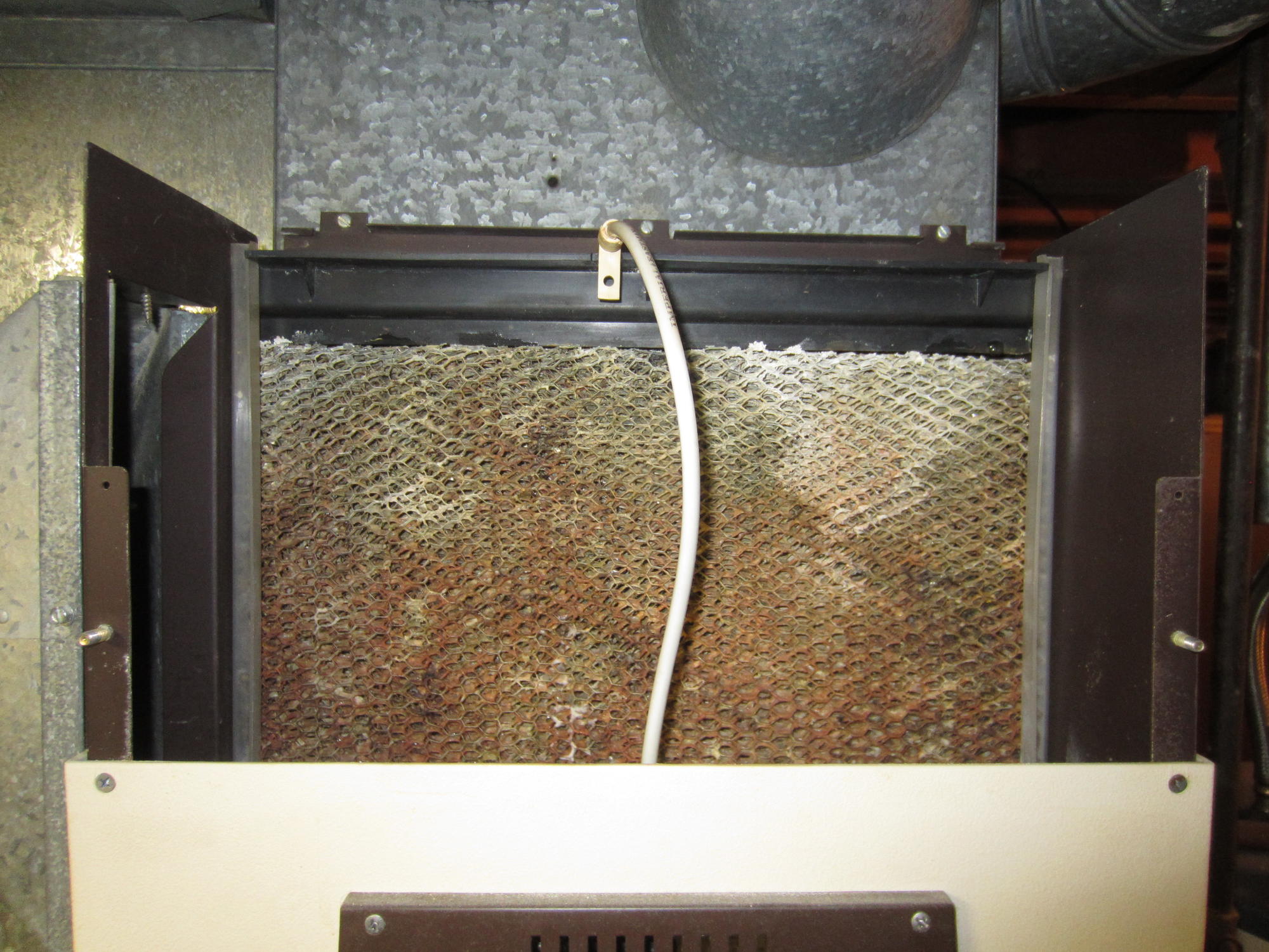

This is an image of a typical humidifier installed in a gas fired forced air furnace. It is important to check the function of the humidifier to verify that any excess water drains properly into the drain tube and also follow the drain tube to ensure that it drains into either a condensate pump or other type of accepted drain. This humidifier appears that the water pad is due for a change due to the dark coloring of the pad. A humidifier can be a prime place for mold to grow and then be distributed throughout the home via the duct work.

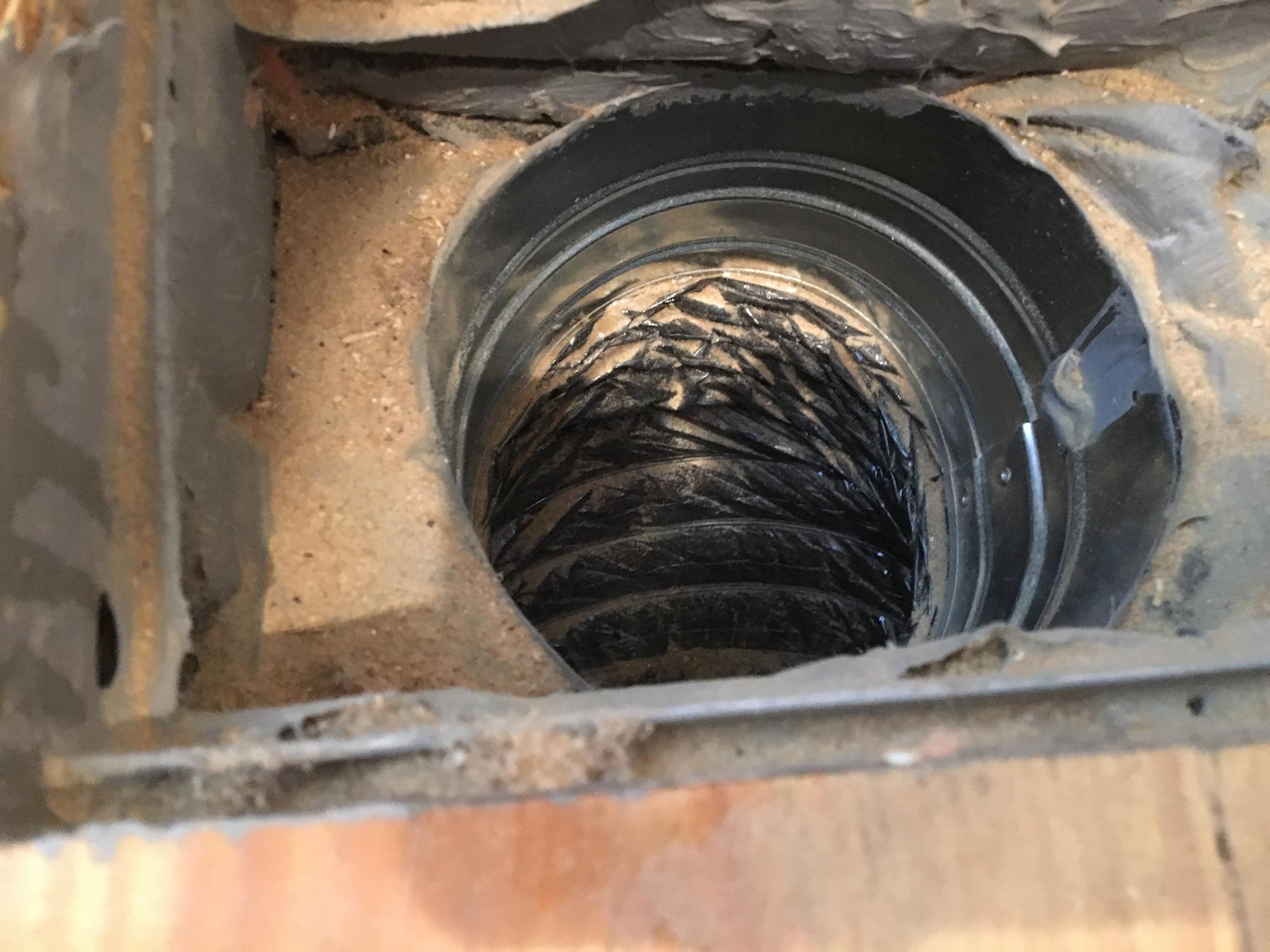

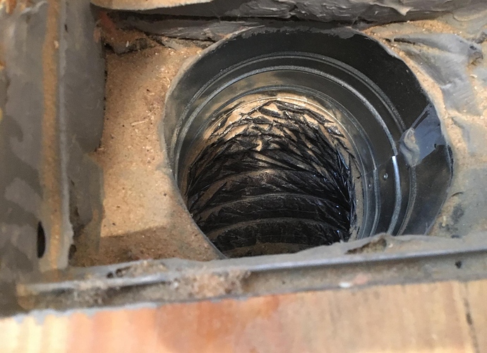

The floor hvac register appears to be free of moisture and /or evidence of mold growth. However, evidence of cellulose material (saw dust) was observed and should be removed to prevent possible future host for moisture-induced mold growth.

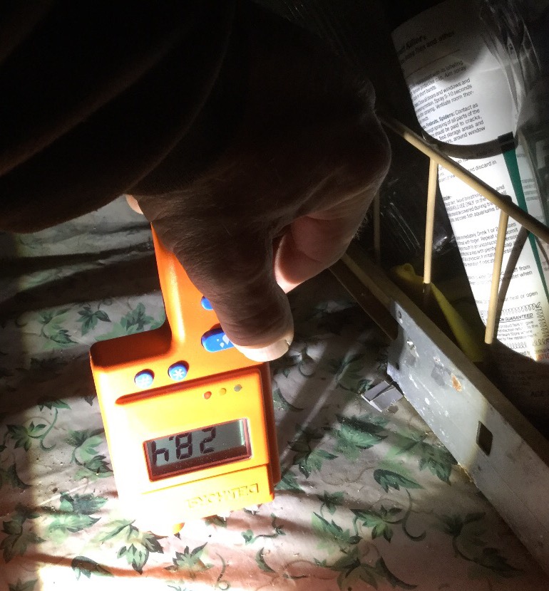

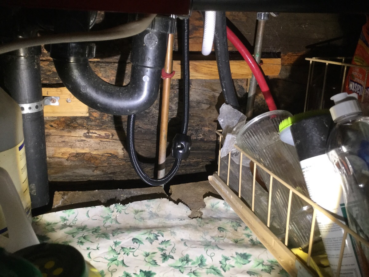

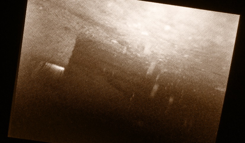

I have a log home rental house in which the kitchen sink faucet had leaked and was replaced. This was two months ago. For my mold essay, I chose to check out the sink cabinet. There is no back to the cabinet so the logs are exposed and had become very wet during the leak. My moisture meter measured the logs at 8 percent, so they are fine. The particle board at the bottom of the cabinet measured six percent where it was exposed to air however in the area that is sealed by the green plastic shelf liner, the level was as high as 28 percent moisture.

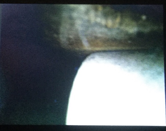

Using a borescope to look under the particle board, I see what appears to be mold. I am going to remove the particle board and let it dry out for a week or so and then replace the piece with painted plywood.
There is a powdery area on top of the particle board that might be mold also, but removing the board will remediate the problem so I would not go through the expense of testing it.

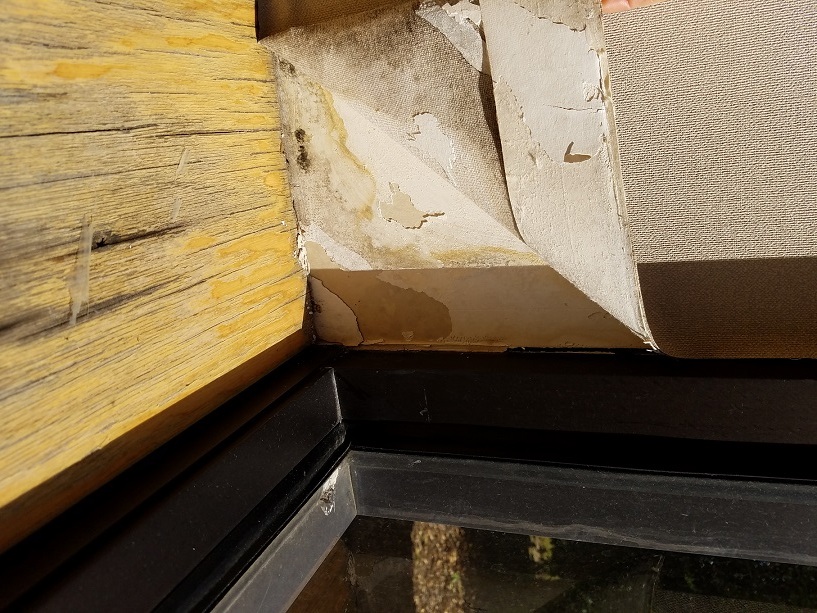

I have taken a picture of a window sill and window casing in a dwelling that is of concern to the residents due to moisture penetration.
There appears to be stains and some type of growth. I would recommend taking a swab sample and air sampling to check for mold spores in the dwelling.
The residents have complained about some health issues they believe to be caused by the appearance of mold. I recommend they speak to a health care professional.

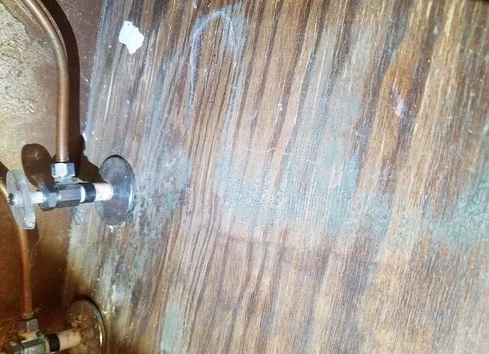

Attached is a photo showing somewhat an apparent mold growth as a result of faulty pipe (leakages) under a sink (wood board type). The presence of water combine with moisture would encourage mold growth under this sink. Eliminating the root cause of this problem and cleaning up all the area under this sink is vital.
