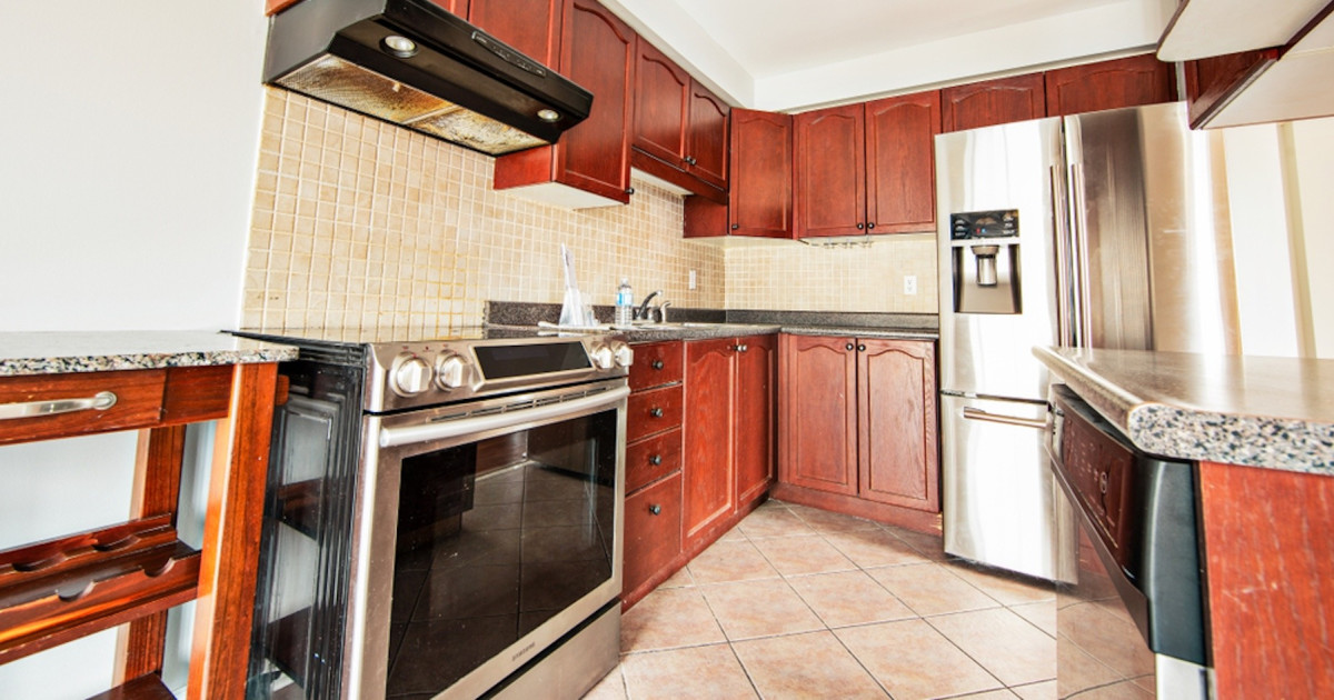

Excellent checklist. A few things worth noting according to the NEC which may differ from other codes:
Check the power supply to the electric range. A dedicated 240-volt branch circuit outlet (minimum 40 amperes) must be installed within 3 feet (914 mm) of the electric range appliance. It’s common to find a double-pole 50-ampere breaker at the panelboard connected to a 6-3 wire labeled “Range.” Modern ranges will have a 4-wire cord plugged into a 4-prong outlet located behind the appliance. Refer to 2024 IRC 3702.10.1.
The branch circuit in only required to be a minimum of 40 amps when the range has a kW rating of 8¾ or more. There are electric ranges that have lower kW ratings and are code compliant on a 30 amp circuit. {210.19(A)(3)}
If the cord and plug/receptacle combination are serving as the disconnecting means for the range (typically they do) then the receptacle must be located at the base of the range accessible by removing the bottom drawer. {422.33(B)}
210.19(A)(3) Household Ranges and Cooking Appliances.
Branch-circuit conductors supplying household ranges, wall-mounted ovens, counter-mounted cooking units, and other household cooking appliances shall have an ampacity not less than the rating of the branch circuit and not less than the maximum load to be served. For ranges of 8¾ kW or more rating, the minimum branch-circuit rating shall be 40 amperes422.33(B) Connection at the Rear Base of a Range.
For cord-and-plug-connected household electric ranges, an attachment plug and receptacle connection at the rear base of a range, accessible from the front by removal of a drawer, shall meet the intent of 422.33(A).
