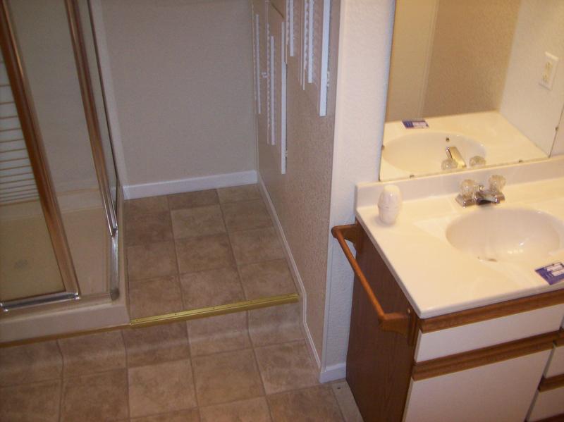

Shower stall and sink. No toilet.
Why do you ask?
Just to elicit discussion. ![]()

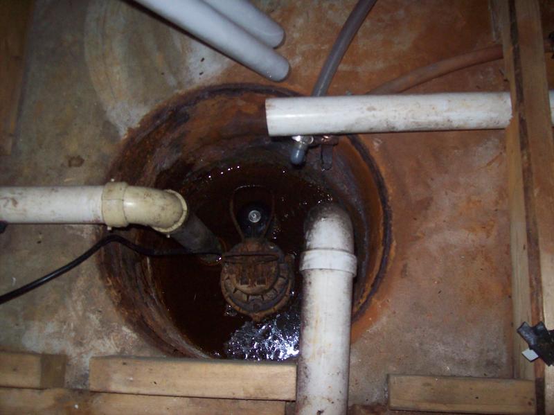

The two fixtures shown drained into an an open sump basket with submersible pump and no alarm.
“Gray water” only… allowed in many areas.
Thank god there is no toilet.
Not around here or where you are at.
You need to get out to the farm homes more often. Usually see similar with the basement showers the farmers had to use before Mrs. Farmer would allow their arses in the house!
Note: these homes are typically on Septic systems also.
Oh I know.
This is not my first rodeo.
This was on septic.
I know you know.
It was more for the education/information of others/newer inspectors.
Once you get out of incorporated areas, almost anything goes. There are many areas I inspect that have no AHJ’s to inspect, anyway.
