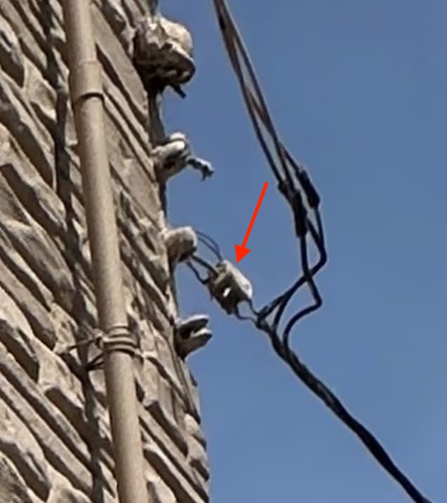

Or, the electrical service drop?
Looks like a faux stone veneer. It is a cementious product similar to stucco.
The electrical drop.

Could you describe what you see in these pictures?:
First pic: loop deficiency. Second and third pic; I have no idea.
What is the loop deficiency?
Correction…droop
[quote="Darius Lowery, post:14, topic:241394, full:true, username:dlowery4”]
Correction…droop
[/quote]

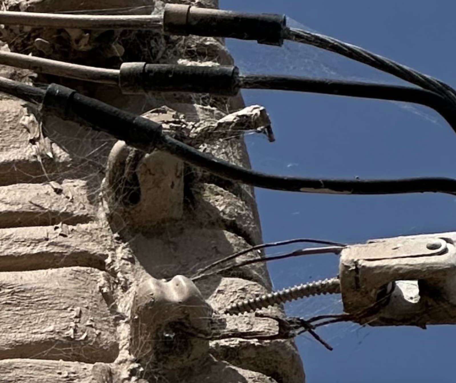

Example:
The service drop is improperly attached to the home.
What’s the mechanism between the service drop and building? Square device?
If you mean this, it is an old used porcelain insulator.
The old riser is covered by the Formstone. The old anchor was pulled out to allow the application of the Formstone.
The weatherhead is higher than the anchor.
@lkage has a good eye and is spot on.
On a service drop, the two insulated “hots” bring in 120v each, and the bare neutral conductor provides structural support for the entire service drop.
In this photo, you can clearly see the bare wire support.
Your image shows the bare wire support pulled away and compromised. A makeshift wire loop is now holding the service drop, which is a very dangerous situation. Furthermore, the hot wires are now pulled tight due to the attachment issues, eliminating the drip loop.
