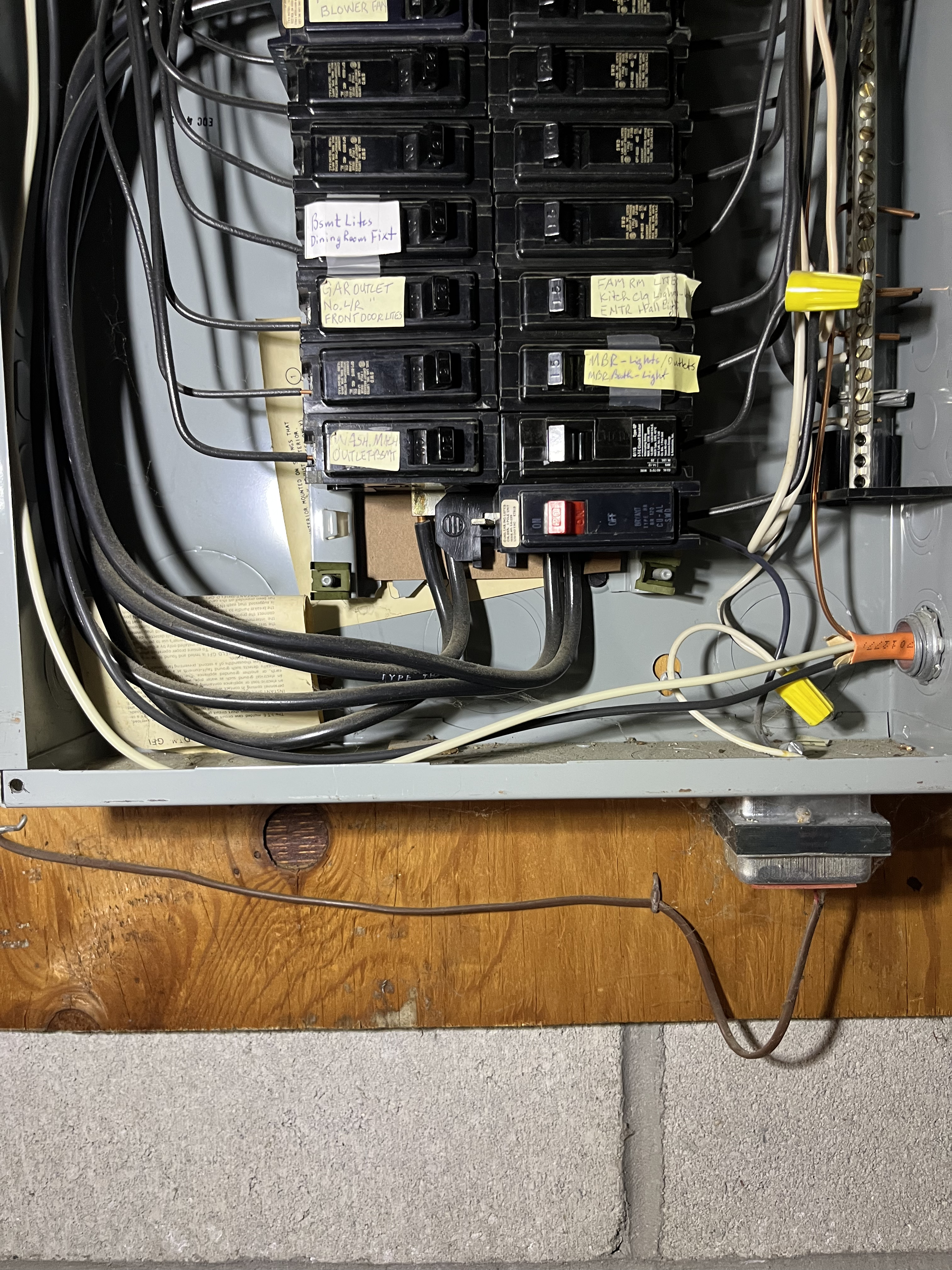

Looking for some help here. I ran into this ITE Imperial Corporation panel yesterday. This appears to me to be a split bus panel however i find it strange that the breaker that feeds the bottom half is double tapped and brazed/soldered to the bottom bus bar. Can anyone confirm if that is what i’m looking at? Where they built and shipped from the factory this way? Does this pose the same safety concern as a typical double tapped (50amp) breaker?

Your assessment seems to be correct. It does appear to be factory. The thread that Brian posted showed a similar setup that even the resident expert hadn’t seen before. Good find and thanks for posting, Ryan.
Did you notice the Homeline 20-amp 2 pole breaker on the top left? Seimans QP breakers are the direct replacement for ITE breakers.

I concur with Richard. Good catch.
Split-bus panel. Six switch rule. Obsolete vintage equipment.
Bryant breaker. Bottom right. Manufactured before Westinghouse ceased their production in 1988. <40 years old.
Mixed beakers. Squad D & Bryant.
Standard ITE replacement would be Gould.
I think split bus panels are a red flag.
Obsolete would imply that the equipment is no longer serviceable. Maybe you’ll find a Gould breaker on eBay. but the direct replacement of an ITE Gould breaker is a Seimans QP breaker.

Split bus panels are allowed, but yes, this is odd that the feeder is doubled up like that. I have never seen that at all. One other thing not mentioned would be the open knock out on the bottom right, beyond what others have posted.
For the split bus, I explain it to the client as to how it works because there is not a single breaker throw as most expect. I also explain that it is likely 40+ years old, and aged technology, but fully allowed by standards set forth. I do not think they are a red flag at all as they are allowed with under 6 throws.
