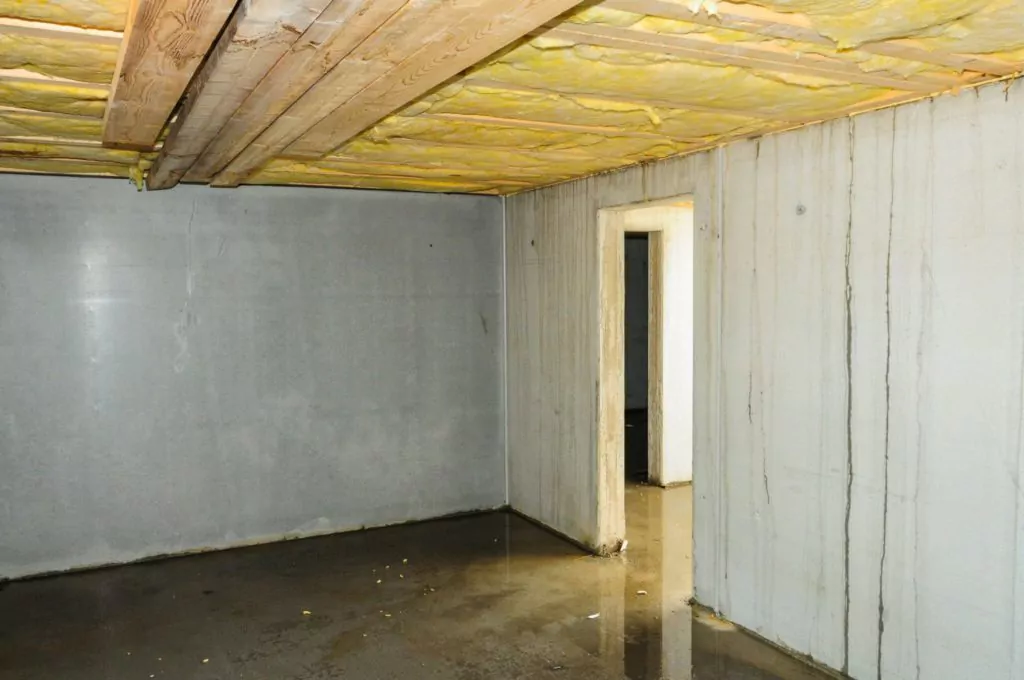

Leaky basement and some tell homeowners to raise and slope the grade???
Concrete huh? So again, some home inspectors/realtors etc incompetently tell homeowners like this homeowner they should mudjack 1+ slabs INSTEAD of finding/fixing the actual existing problems where the water enters.
There WAS concrete right up against the house/wall, right where we dug.
So please exxxxxxxxxxxxxxplain in full, exactly how mudjacking any slabs repair/waterproofs any exterior crack in basement wall or, other exterior opening and… please explain how mudjacking any slabs keeps SUBSURFACE water from going, getting underneath driveways, underneath RAISED grades etc and then going through a crack in a basement wall as in the stoooopid video???
A few times a homeowner may be getting a little water in basement and they think 1 or more concrete slabs that have settled a bit is why they leak and so, they mudjack that 1+ slab, and maybe won’t leak for awhile… as in this photo

You said you own a house that supposedly has… ‘perfect basement walls, crack free, and the wall were perfectly parged on the outside’… right?
So we’ll assume your foundation walls then, IF parged, are block or brick foundation walls.
Block and brick walls OFTEN have 1 or more EXTERIOR cracks in them with NO VISIBLE cracks seen inside. These cracks can be just cracks in the exterior parging or actual cracks in the block, outside.
So just because you and others may not see any crack on the inside walls does not ever mean there aren’t 1 or more exterior cracks… or OTHER exterior openings in the wall below grade, or ABOVE grade.
Wish you’d explain how you know without question that the parging on the outside of all your walls is, ‘perfect’. The ONLY means of doing that, of knowing that, would be to be able to SEE the outside of the wall, see the parging and, nobody can do that without digging. So in my honest opinion, you do not know the true condition of the parging, of the exterior of the walls.
And sir, what I would have recommended to you, as I have many other homeowners (in order to truly find/identify the small leak), would have been, run a water-test.
Because, sometimes a homeowners ONLY problem (where the stupid water FIRST-enters), is… ABOVE ground, above grade, above a patio,concrete slabs.

So, some homeowners do NOT see any crack on the inside of their block or brick basement wall. Well shtt, that means… nothing!!! It does not at all mean they don’t have an exterior crack or cracked exterior parging on the OUTSIDE of the wall. Hello?
Inside a basement, homeowner leaks in this area, at bottom of wall/where bottom of basement wall and the floor meet.
In this basement (and go FULL screen on this/any video), other than a step crack you don’t SEE any cracks when you look at the block wall
BUTT, on the outside (this video), you’ll see multiple cracks. One more time, most of these exterior cracks are NOT visible on the inside
Just because a home inspector or homeowner or realtor etc etc does not see any crack in a block or brick basement wall when they look at the inside of the wall, does not ever mean they’re aren’t 1++ exterior cracks and anyone who says differently is completely full of shttt, incompetent and they are quite a few, truth hurts sometimes.
And parging? Nobody has Superman vision so nobody knows whether there is 1 or more exterior cracks in the parging. Even on NEW homes, say a week old. One may think and hope the parging hasn’t cracked, but it sure as shtt could already be cracked.

Here, loool, simply put… they leaked because there was a crack in the block wall, PERIOD.
Had there NOT been a crack in the wall or any other opening/crevice etc below grade or above then they would not have leaked.
There are many homeowners with leaky basements, some with mold and-or efflorescence etc who DO want their problem(s) fixed once and for all. They don’t want to guess and play games and keep cleaning shtt up or hope they don’t leak on the next decent rain or thaw. They don’t want to sell their house and worry about getting sued. They want their problem(s) found, and then fixed correctly. Is that much to ask? Nope.

The PHOTOS clearly show the wall is bowed in, and there are multiple exterior cracks, no parging and… some DISINTEGRATED blocks.
