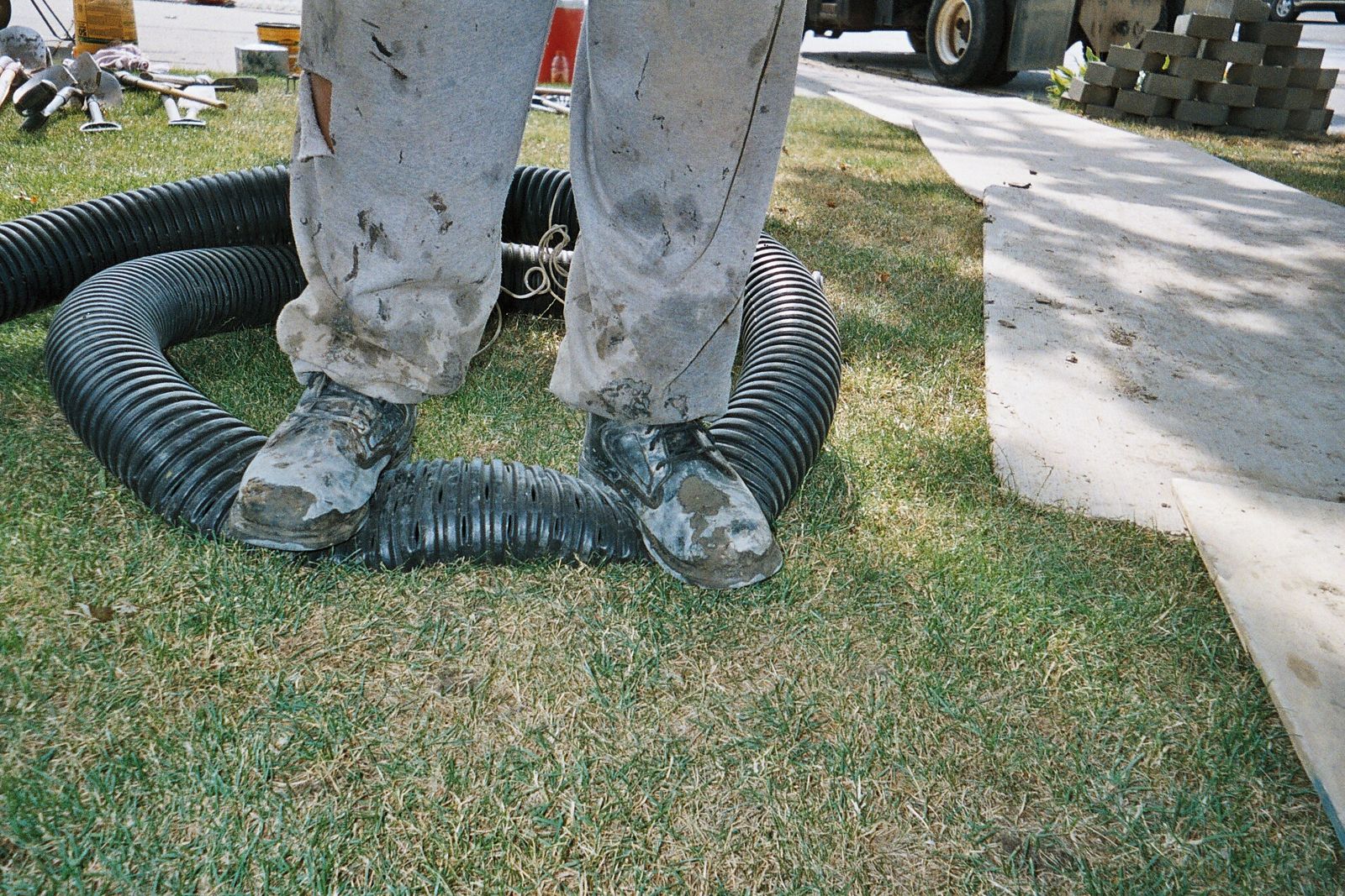

… so they did, kept leaking loloooll SAME Old bs
what was OPEN underneath and abut-to the concrete, yeah
as usual, leaky basement had nothing to do with a supposed need for new drain tiles inside or outside, no need for, ‘better drainage’ outside they already tried that n spent $ on concrete
St Clair Shores, leaky basement front corner, block wall
Gee, it just HAS to be clogged drain tiles right? lolollllllllllllll incompetent as can be!
here’s some moronic drain tiles just below grade for those water management wieners
gee, might there be an exterior crack or cracked parging allowing the water in
clay soil
let’s pretty-up the stupid drain tiles for the inspector who is on site for about 1 minute looololllll
put a little weight on the cheap stupid weak az black perforated drain tile which is A-okay to use per code and city inspectors, more dumb crap
this is better, COSTS MORE lol but better for those ‘into’ drain tile nonsense
imo clay tiles are best, just my stinky 2 cents
