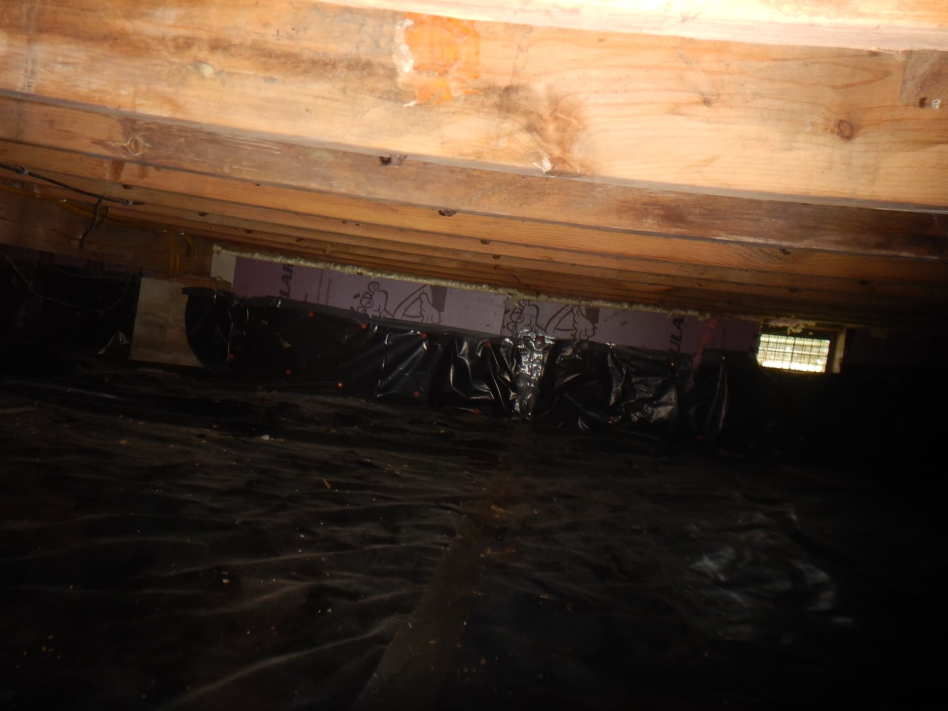

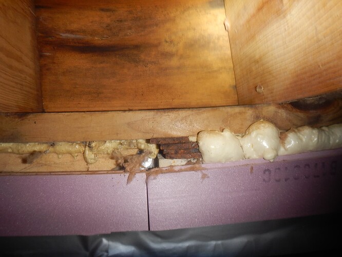

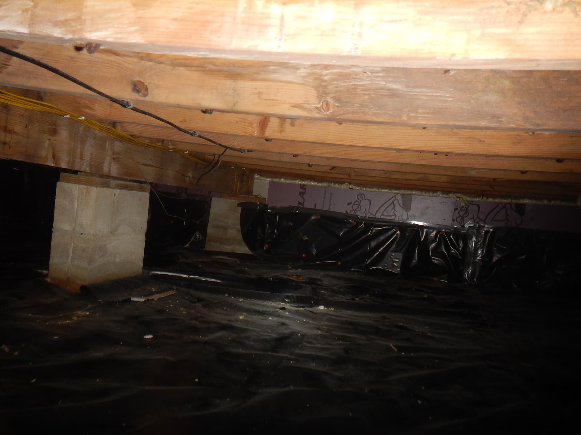

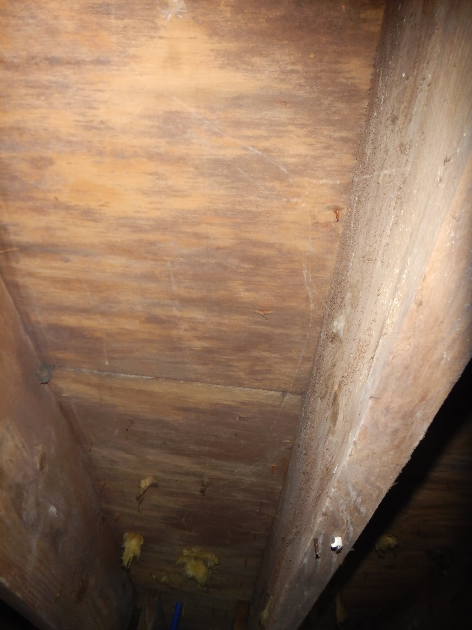

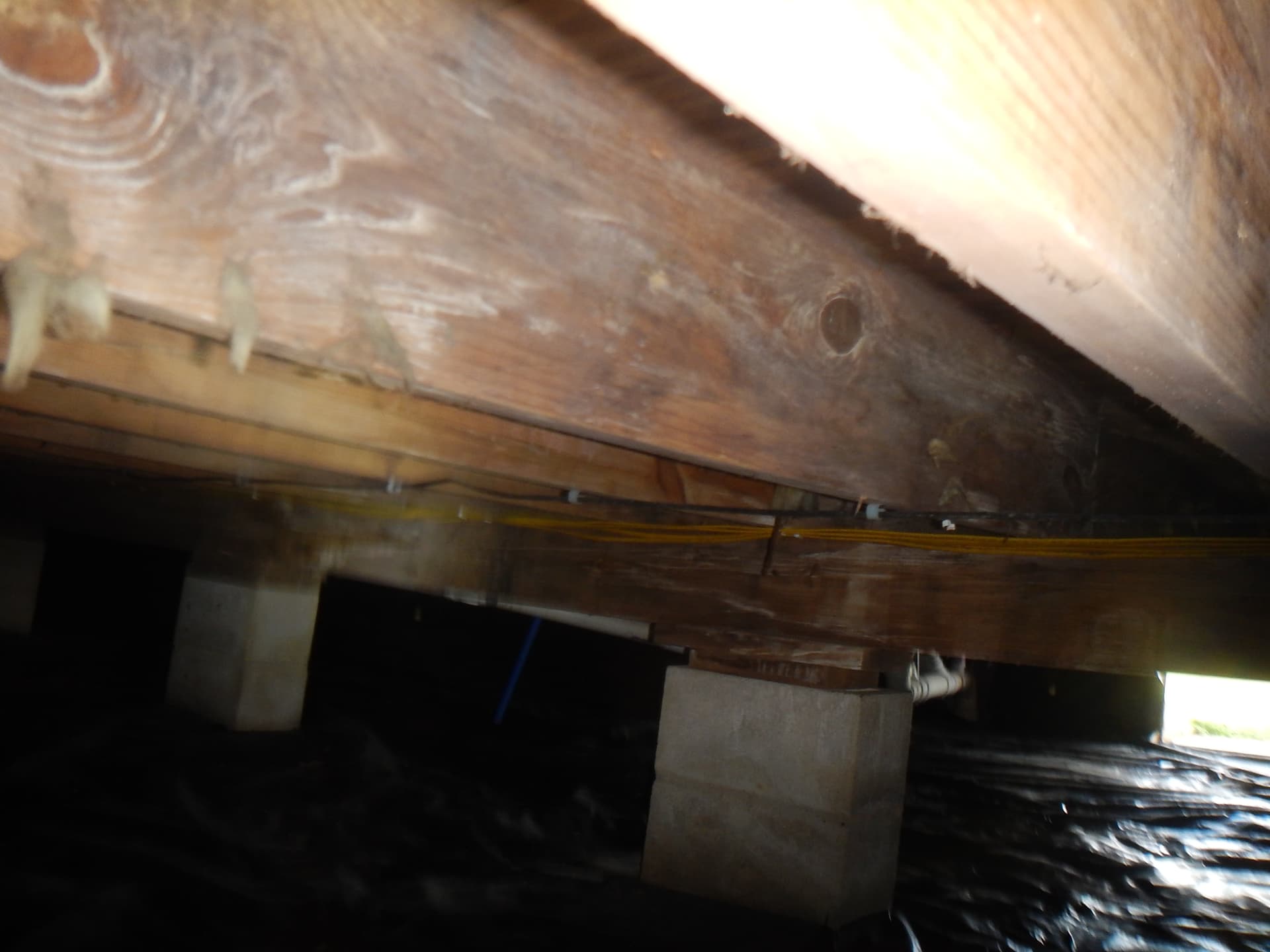

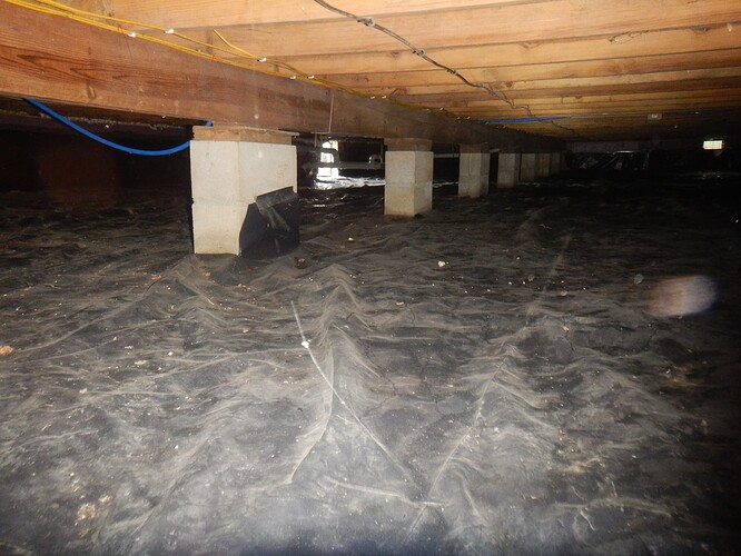

Is it possible for some to remove the frame from under a double-wide? This home has all the appearances of a double-wide (manufactured) including dimensions, 27 x 56. The floor joist and subfloor have moisture stains/mildew growth. The subfloor has places where visible pieces of insulation have been nailed to it. There are rows of staples about 4 feet apart in the floor joists, the entire length of the home. There are approximately 1 inch of metal shims between the top block and the sill plate around the perimeter. There are bolts going through the sill. The entire perimeter is insulated and spray foamed so very little is visible. There are two places where I can tell one of the top blocks is missing.

Thanks to everyone for all the insight. My training has also been that HUD only regulated Mobile homes and the modular homes had to be built to the local building code. Which was part of my concern here. A home built to the local building codes wouldn’t have the floor joist insulated, it would have had perimeter insulation with rigid foam. The property tax card has the home classified as a manufactured home (since built in 1992). I talked to the county today and they found in the notes that in 2015 someone had written "the home is stick built, not manufactured. The PRC however wasn’t ever changed. There were no data tags anywhere, in the closets, in the cabinets, or at the panel. The home was completely remodeled at some time so that could have been removed. Due to the fact that the sill is now bolted, I reported it as modular.
Did you look in the crawl space to see if there was a marriage wall connection? that would determine if it was stick built or manufactured.

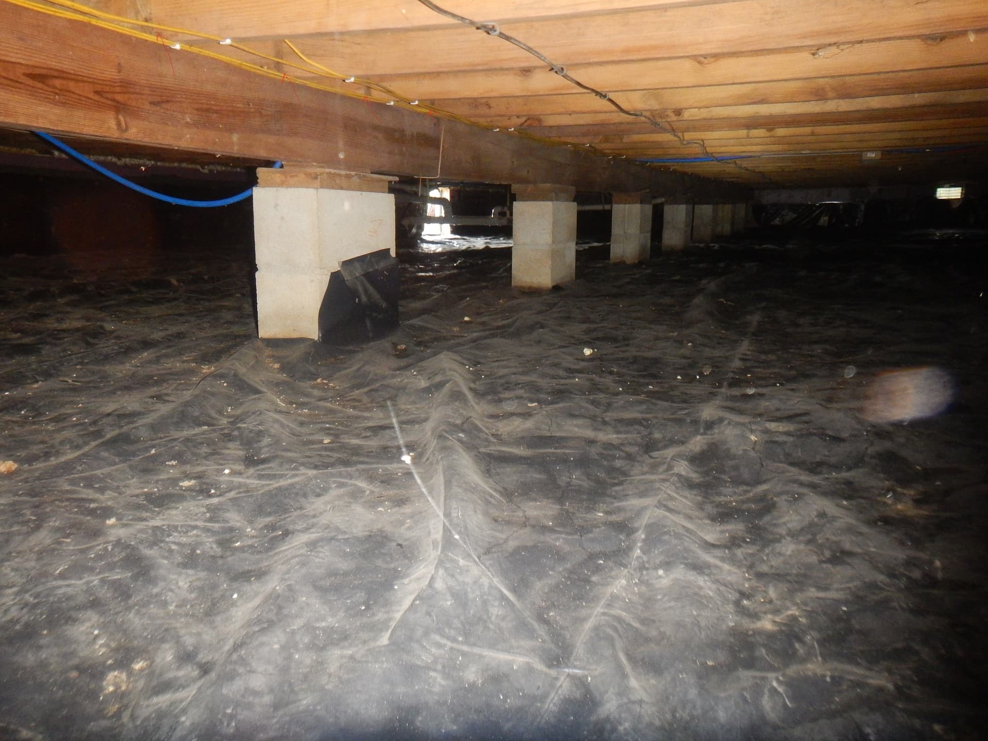

Good thought Scott, I didn’t but I have 75 photos. The joists overlap the center beam.
Does the marriage wall usually have a beam? Seems to me the connection would be the beam. I do not see these often so I do not recall what I have seen in the field.
It could be a factory built panel home assembled on site with on site conventional deck framing.
The joists rest on a center beam, which is common in this area. My daughter and son-in-law had a true modular that rested on the center beam. The main difference I have come up with is how the home is connected to the foundation. A stick-built or a true modular home has the sill plate attached to the foundation with studs, washers, and nuts. A manufactured home has tie-downs with anchors in the ground. Many manufactured homes in this area have concrete blocks used as underskirting but the home is still attached to the ground with anchors. I have left this one as modular or prefab. Thanks for all the good information shared today.
