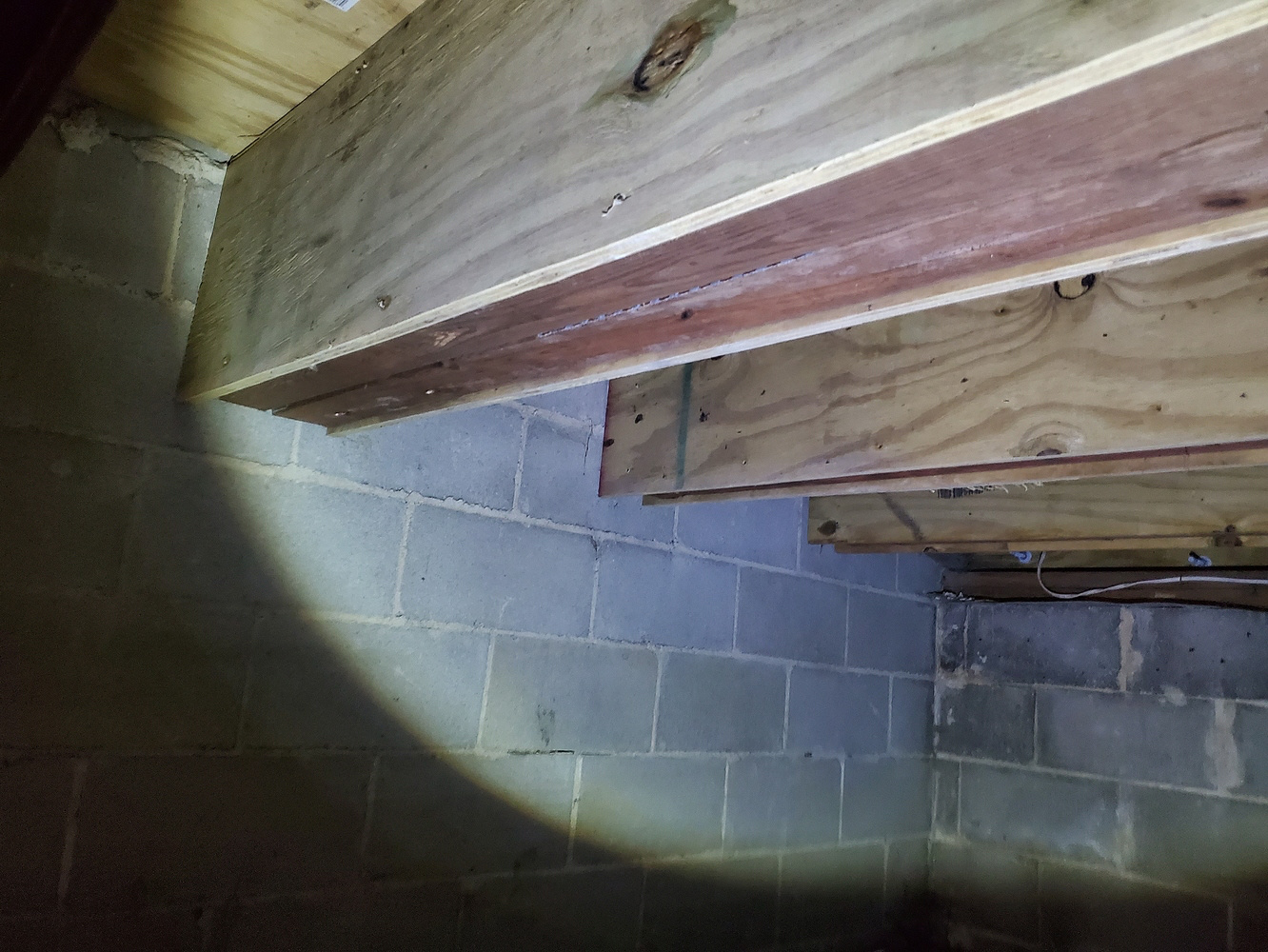

Modified floor truss system?
Just inspected a beachfront townhouse and the whole crawl space was done like this. They have ripped plywood and attached it to either side of the floor truss system all the way across. The little bit I could see looked like the metal brackets that hold the trusses together had corroded. Also for what ever reason they add support posts down the middle span of these but they’re not even touching the trusses? Anyone ever seen anything like this. This crawl space was definitely flooded during super storm sandy.
Drew, I would make sure that they present an engineers fix stamped paperwork as part of your report.
Also, it may be wise to refer for further investigation of the wall systems for moisture damage and undermining damage (think filled back in but not compacted.) of the foundation system.

Walls were concrete block original to the home, theres sand in the crawl space and outside. Honestly I didnt see anything going on with the walls, the place was a middle unit with a bulkhead in the back that looks like it was recently rebuilt probably after sandy. Doesn’t hurt to have them looked at though. I will be going with what you said about the trusses, an engineer would of had to approve this originally if not then they will need one to give it the stamp of approval or not. Thanks again Larry

The brackets that I could see were pretty heavily corroded. Plus organic growth on the bottom of the visible trusses. So probably quite a bit lol.
My guess is that, yes they did have an issue with the gangnails rusting (which can happen especially in coastal areas) and maybe the trusses were under engineered for the span. Looks like they tried to fix them by turning them into old fashioned box beams and adding a center support. Box beams can be strong provided they are nailed correctly. Probably only an engineer could tell you if this repair method is acceptable here.
I agree with you, Ray. This doesn’t look like it is nailed nearly enough, ( I’d think adhesive, too.) IMHO:

It don’t amount to much recommending an engineer, once he gets there, he will require that plywood be removed so the web truss plates and connections be examined.
So you might as well recommend a qualified licensed contractor with engineers in house to evaluate the condition and repair accordingly.
This could end up being an expensive enterprise.
You’re right…I noticed the lack of nails too…
