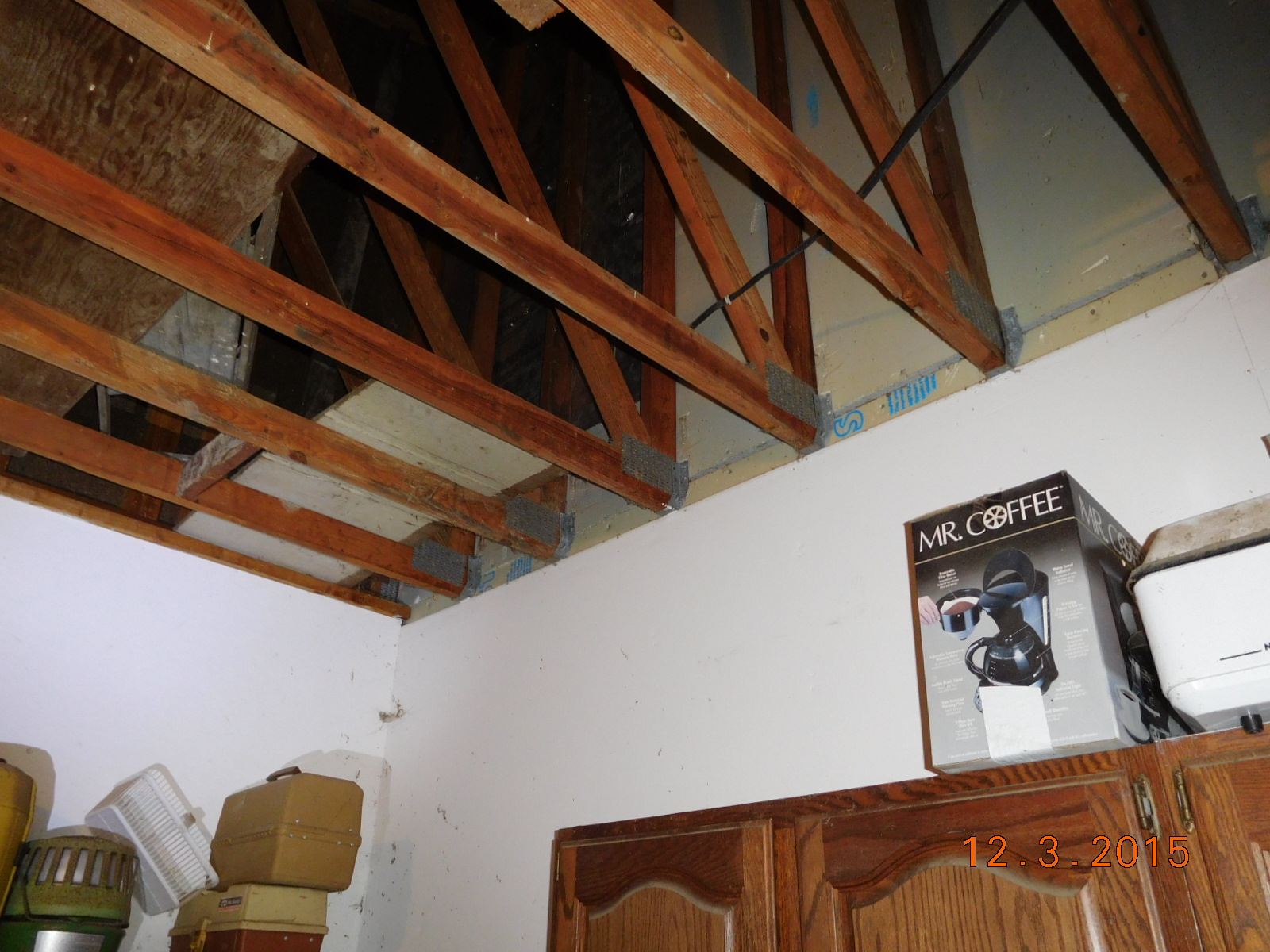

Mono truss thoughts
Home was built in 79, there was no deformation / deflection to the roof observed. No diagonal bracing was observed (normal for this era), I will recommend the bracing be added. Top cords extend over the house wall but not sure about the bottom cord attachment over the ridged foam. What are your thought about this attachment to the wall? This was for the garage area.
Knee wall truss…

You said no diagonal bracing was “normal” but you are going to recommend it anyway?
Like Roy said, it depends on the length of the nails but without any observable issues I may not report anything as defective.
Perhaps make a note and move on.
If those knees terminate on an exterior wall that are not correctly attached. Straps or clips need to be installed.
From his photos, they don’t
Then they are fine.

Are we talking diagonal bracing on the gables…?
No need anywhere else if 24" OC.

The guy was a mechanical engineer and we talked about the bracing and he understood that it was normal back then and thought it would be a good idea to add before he adds drywall to the ceiling (fire separation). The wall had him confused and I thought it was okay but thought and knowing are two different things (I had a small amount of doubt) is why I asked.
