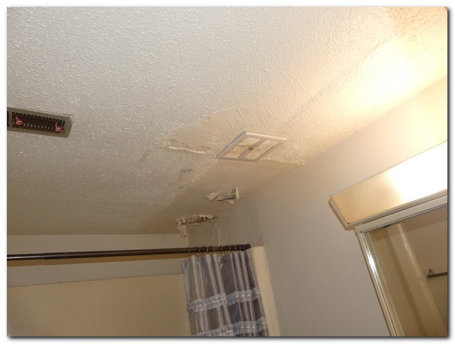

Having access to all the units on the day of the inspection is critical, you don’t want to drag this out over several days. In my reports the exterior of the building, roof and crawlspace are inspect and reported as if its one building. I then inspect and document each unit separately. The first picture I take of each unit is the unit number on the door, so you can keep track where you were when reviewing the photos. Identifying which outdoor AC unit goes with each apartment can be difficult. On a rare occasion the unit number is marked, but typically not. The inside furnace may be a different brand than the outside units due to replacement. If you can get the building maintenance man to go along and unlock each apartment is ideal. If any units are vacant I like to start there first. This lets you get an overall picture of how each unit is arraigned, where the furnace, water heater and electrical panel is located. The furnace closet in an occupied apartment may be stacked to the ceiling with junk, so decide how much stuff your willing to move. Be careful where you sit your tool bag, you do not want to bring bed bugs and cock roaches home with you. Just about every multi-unit apartment complex will have a sick child or grandma sleeping in a bedroom. Be prepared to document why you didn’t inspect any particular room. Plumbing leaks from units above is typically the main source of issues I find. I have inspected 8, 10, 12 unit apartments where 100% of the bathrooms have leaked and damaged the unit below. Here are a few photos to get a feel for what you may see.
