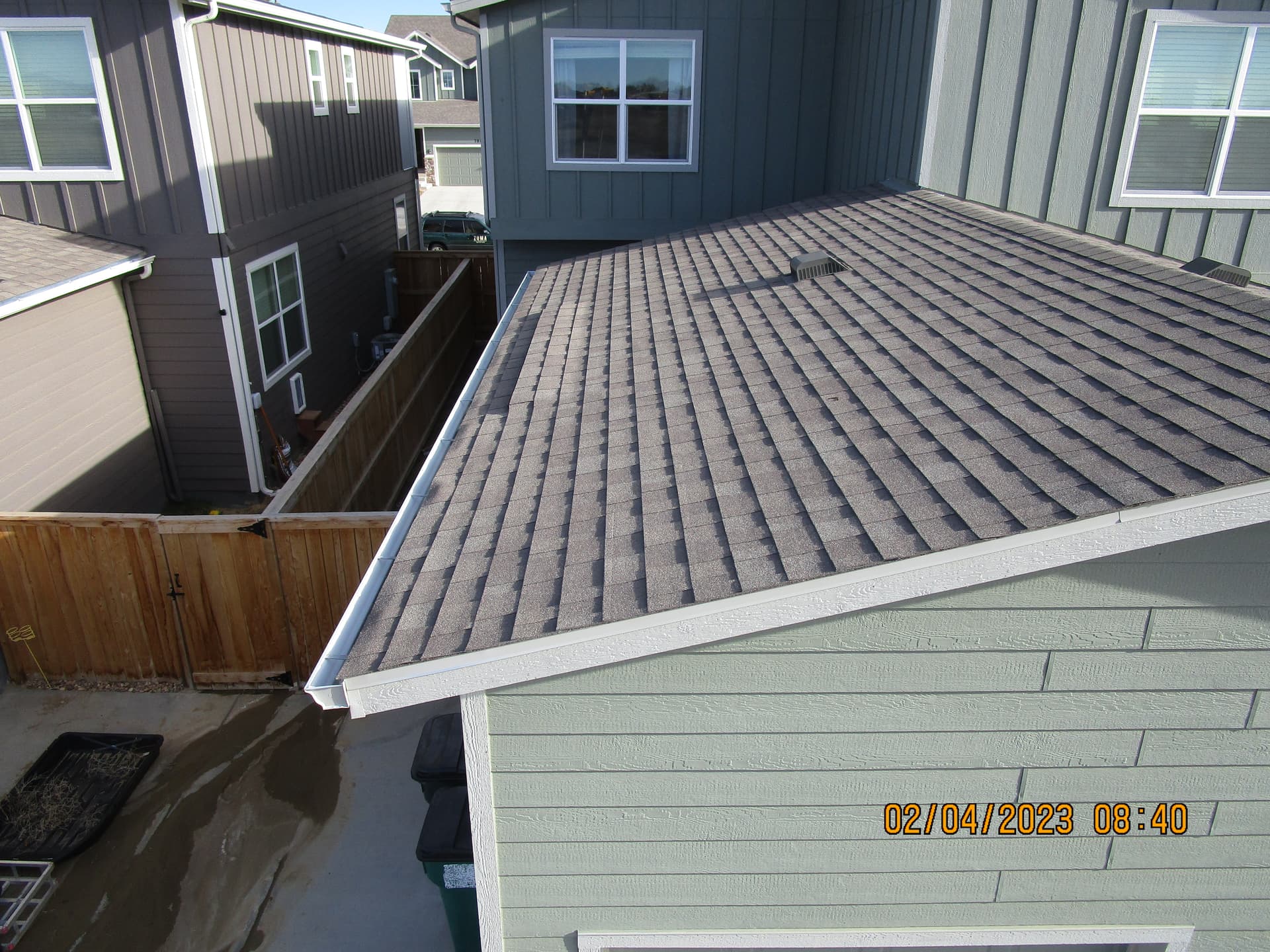

Here is a picture of the roof in the area for perspective.

@ryoung7 the section on the right in the “standing further back” picture had a rolled bark edge on the bottom, making it look like a 1X. I tried to get a close up picture of it but my attempts were useless and out of focus. There was a car in there with a dead battery against that wall, and it couldn’t be moved, making taking pictures difficult to say the least.
