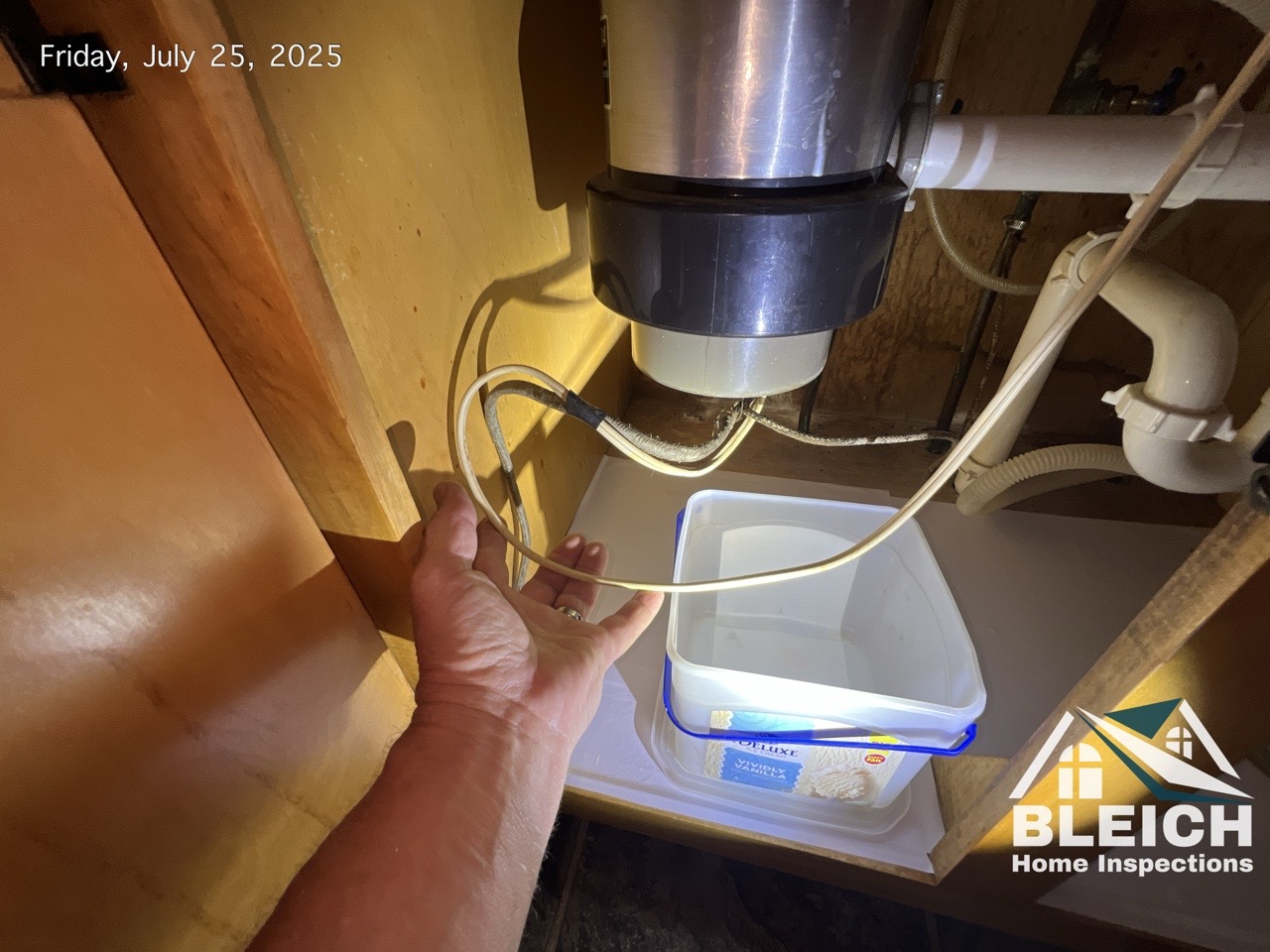

A hardwired disposal was found. NM cable was not protected from physical damage. What appeared to be lamp cord was used for the switch leg. Recommended correction by a licensed electrician.
@rbleich, checklist is updated with: “Type NM cable cannot be directly connected to a garbage disposal unit because the cable would not be protected from damage as is required by code (Refer to 2024 IRC E3802.3.1). Flexible metal conduit and flexible cord are the two most commonly installed wiring methods for garbage disposal units. Flexible cord is ideal, because it makes installation and removal easy. Refer to 2024 IRC E4101.3 Commentary.”
