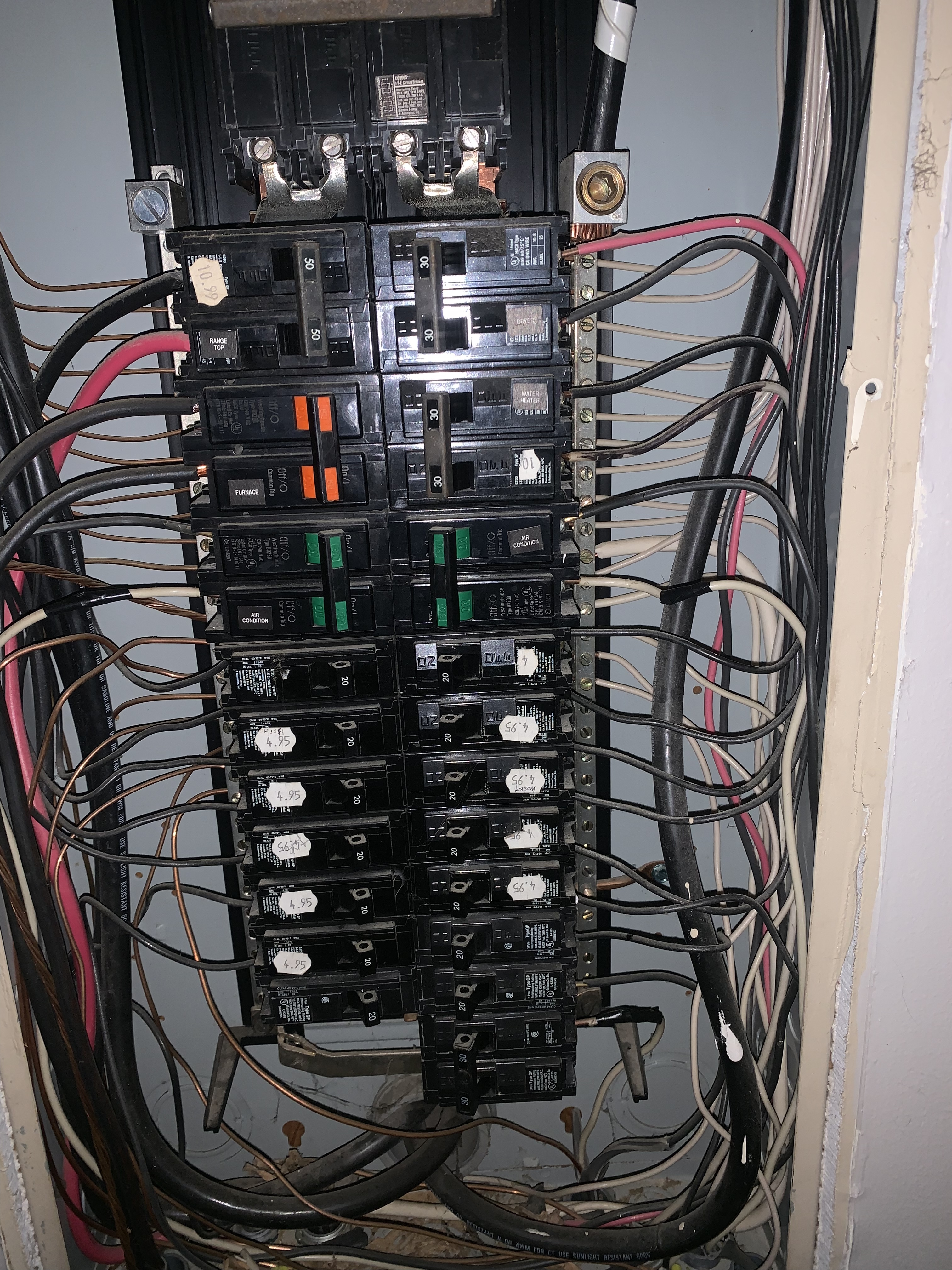

Wondering if I’m missing something, there is a GEC visible on the exterior of the house that exits from under the vinyl siding below the meter . But I can’t find the GEC in the service panel .
I assume its grounded in the meter but should there be a GEC from the grounding bus to the meter or does the neutral serve that purpose.
The conduit from the meter is PVC if that matters
( I know there’s other things wrong in the panel )

The lack of a GEC coming into the box , and can I say its grounded if I can’t actually see where the conductor is going?
Do you have to say it is grounded in your report?
no , but my initial reaction was that its not so guess my head got stuck on proving it is lol
We can only see 2/3 of the panel.
I have to take something out of my brain to try to remember but I believe the GEC can be from the meter, the service disconnect panel board and I think somewhere else. But, I can’t remember that location. That is assuming everything else is done properly.
The GEC can land between the service point and the service equipment.
So the panel just bonded to the neutral doesn’t cut it ?
It does in my area. The GEC and Grounded Neutral are bonded at meter.
Chris is correct… I misunderstood what you had going on. If the GEC is in fact bonded to the neutral inside the meter enclosure correctly, then to prevent a parallel current paths the service panel and the meter enclosure should not be bonded using any other means such as a metal conduit or EGC. So what you got looks correct in that regard.

I think the way I phrased my prior post may sound confusing. This is how I understand it: A number of AHJ argue that the metal raceway between the meter socket and the service panel violates NEC 250.6. Running additional EGC between the meter socket and the service panel when the GEC is bonded to the neutral in the meter socket can violate 310.10(H) and is unnecessary because the bonding of the meter socket and the service panel is permitted by 250.92(B)(1) using the neutral conductor alone.
My electrician buddy got back to me and said it was good, I went out with him today and he showed me the same thing.

If you can not see the GEC,it becomes a ‘limitation’ visually. No worries. BUT. Use a tool to measure the presence of ground. Three bulb receptacle tester or circuit analyzer.
Your assumption, “I assume its grounded in the meter but should there be a GEC from the grounding bus to the meter or does the neutral serve that purpose” can be answered here.

I recommend everyone watch the “advanced electrical course” on internachi with ‘the electrical guru’. He states that after 2008 if there’s copper water pipes, it MUST have a gec conductor within 5’ of entry, bonding the pipes to the panel, PLUS an additional GEC with ground rod, ufer, etc.
Also, If there is a metal sleeve connecting the panel and meter, it must have a metal bonding lug nut with bonding strap to the panel case. That is (I believe) to keep the sleeve from ever becoming energized. It must be bonded, not just a plastic lug nut.
I see this common in FL. From my understanding is that the ground and neutral wires are bonded at the main panel, so the neutral wire at the main panel then is connected at the meter with the grounding wire that leads to the earth.
So in that scenario, the GEC can come from either the meter or the panel, correct?
