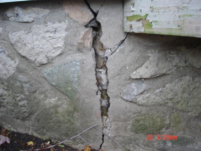

This hundred year old house had everything including this 2" crack in the foundation and when in doubt just go threw the beams. I found holes like this on two supporting beams in 3 different spots. How would you call it out?

The second picture looks like the stone foundation needs to be patched.
I wouldn’t make a big deal out of it.

As to the stone rubble it is not uncommon to see this in foundations of this type. It could be patched, but is a discretionary improvement or maintenance type issue.
