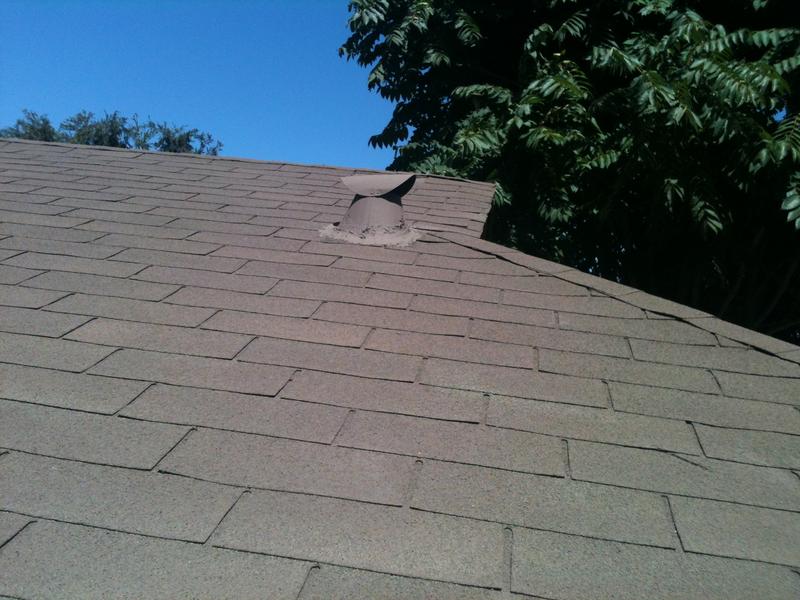

I just inspected a roof and the roofing material was spray painted the same color as the rest of the home? The home is renovated by a seller/investor, i may add that the roof have three layers of asphalt shingles on it, I think the third layer was painted over because it is faded, and this is a quick fix?
I’ve seen that, but not sprayed. Usually it’s the elastomeric stuff and they do it to extend the life and lighten the color of the roof. I use it on my rolled composition roofing on my rental low slope roof every couple years and it does extend the life.
The are companies now that can spray granules on the roof mixed with elastomeric to extend the life of roofs.
No one is doing it here that I know of.
How are you going to write up the three layers?
Remember the average load pre sq.ft. will be 2.10 LBS. or 210 lbs. a square.
that is 700 lbs a square.
Hope it does not snow.
SUSPECT: Warn roof.
Three layers of shingles and a elastomer spray.
RECOMMEND: A government licensed roofer evaluate condition.

RECOMMEND: The roofing material be stripped to the deck, a majority of the shingle fasteners be removed from the deck and all plywood fasteners be checked for lifting and added fasteners reinforce the all good decking material. Any decking material that is rotten, buckled or ply or shearing be replaced.
I have noticed in my experiences with re-roofing layering to many ply of shingles degrades the ply wood decking.
1# It allows moisture to be trapped in between shingle layers with RH being in close proximity to the deck . A cause of buckling or saddling the plywood. A concave indent.
2# The added weight and layers effects nail lifting in the original deck. 3 ply would mean you need a 3" nail to contact the deck by 5/8

C. Re-Roofing: FHA will accept a maximum of 3 layers of existing roofing. If more than 2 layers exist and repair is necessary, then all old roofing must be removed as part of the re-roofing. (4905.1 REV-1, 2-12)
I asked b/c it does not matter what the jurisdiction will allow. Mfr’s Installation Instructions trump all jurisdictions.
Again, I am not aware of any mfrs that allow 3 layers.
Miami-Dade county does not allow it. Neither does the manufacturer. Once you paint the shingles the warranty is voided.
Here is proof of what happens:
