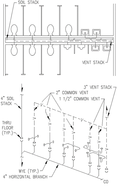

Came across something new today. Combined plumbing vents (not stacked). Code check says “two or more” may be combined as long as they maintain 1/4 in. per foot rise. Is there a max number of vents that should be combined? Also, what about max length on the branch? I assume as long as the rise ratio was maintained it wouldn’t max out.

Is this what your talking about?
When fixtures are connected to one horizontal branch through a double wye, a sanitary cross in a vertical position, or a manufactured fixture carrier, **a common vent for each 2 fixtures back-to-back shall be provided. **(See Appendix K: Illustration BB.)
Section 890.ILLUSTRATION BB Fixtures Back-to-Back in Battery
(Referenced in Section 890.1520(d))
That is an exact Blue Man Group PVC instrument blue print.
Essentially. However, one vent intersects perpendicularly. Basically, three bathrooms, one vent goes straight up and out, one comes up and over and connects to the first one mentioned. The third comes up, over and joins the second one perpendicularly.

I believe you are describing a “circuit vent”…
…in which case a maximum of 8 fixtures are permitted.
The maximum length of the branch is dependent on the size of the trap (the bigger the trap the longer the distance to the vent can be).
The minimum required diameter of a branch or circuit vent is 1/2 the the drain served but at least 1-1/4 inches in diameter. And bigger in diameter if the vent is more than 40 feet long.
If you are talking about the slope of the drain… no. 1/8-inch per foot rise (slope) is fine for 3" and 4" traps.
