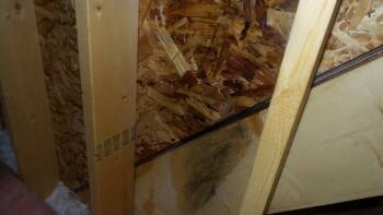

What appears to be the termination of a passive radon mitigation system in the attic space. This home is 3 years old, so always be looking for, to be short, (mistakes) of any sort. Directly above the venting of the mitigation was wet to the touch sheathing. More then likely from condensation created by the mitigation, but can not be absolutely sure.
Any thoughts please send them my way.

Appears to be or is a mit system? You have already described the defects. So call it out and move on. You need to be sure about what you are looking at though.
Very hard to tell from pics why the water is there. Did you find defects on the roof in that area? In my area we have some very tall attic spaces 10' tall and taller. Now if I was in a tall attic space and that small area of water was 10 feet away from the mit system it would more than likely be a leak in the roof. Do you have any more pics showing the whole area?

That could possibly be piping for future mitigation system should one be needed. Only you will know since you were in the basement at one time. If it is for "future" use and not being utilized it should be capped at both ends. Good luck!
