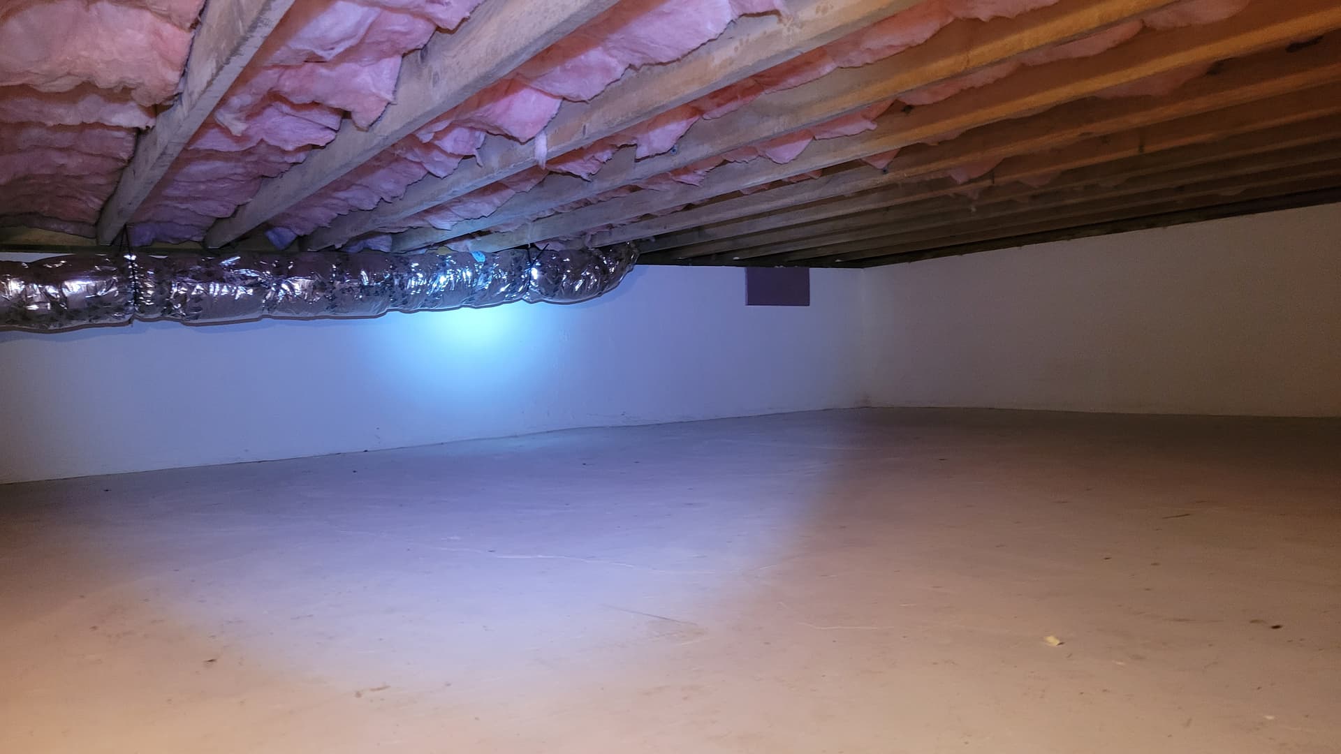

Yes, here are some additional pictures of some crawlspaces with foundation walls - some were very nice with poured concrete floors and HVAC-conditioned, some with earthen floors with poly sheet and gravel and ventilated to the exterior:
Here’s a pier/post crawlspace with earthen floor - was not fun:
Dream crawl, she is marriage material :smiley:
