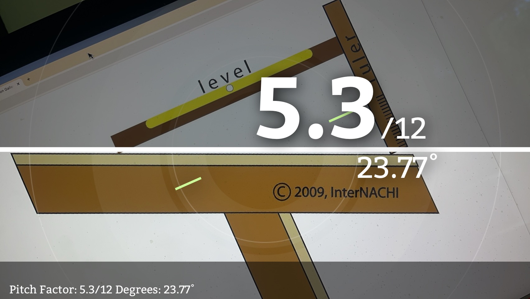

Hi Jesse. Have you looked at Pitch Gauge? It should give you what your looking for.
Pitchgauge is great. Camera mode is awesome.
I agree, Pitchguage.

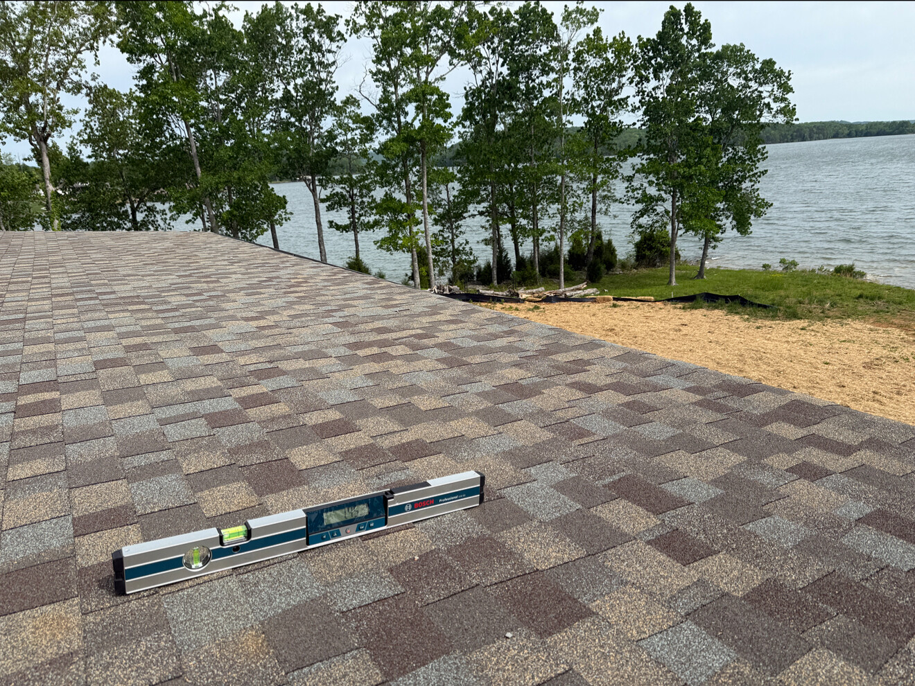

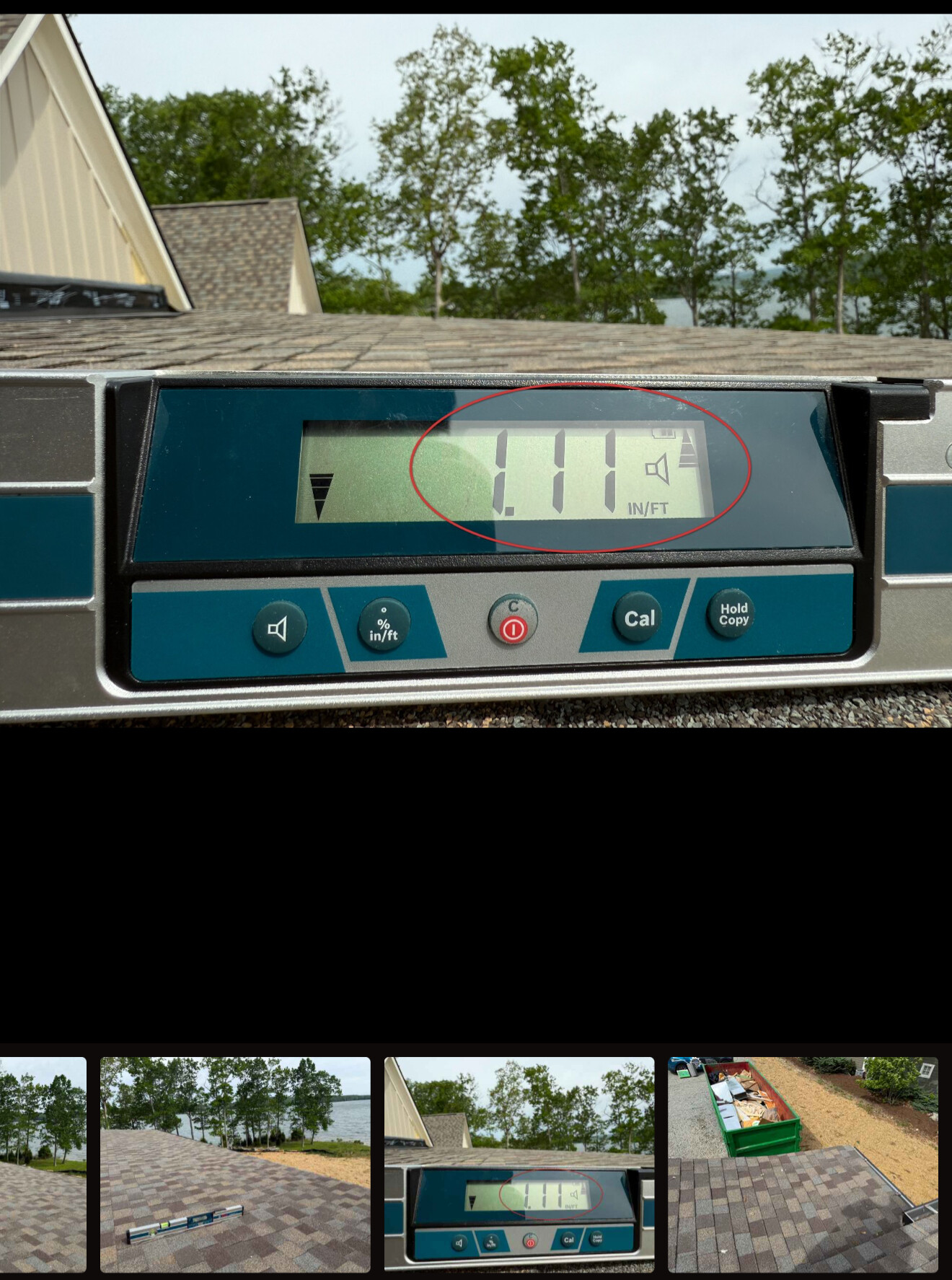

What was the slope angle of the roof in the first image? Is that 1.11:12?
That’s insane to shingle a roof with that slope. You could install a tennis court on that roof and no one would be the wiser.
How about a level and a tape measure? Both are always in the truck. Hold the level with the bubble centered and measure the vertical. 16 inch rise at the end of a 48 inch level = 4/12
A picture is worth a thousand words. Can you imagine what the underside of the sheathing looked like? (Northern Indiana)
Less than 1/12 is crazy, Richard. They will surely have trouble with that one. I find that occasionally when a homeowner decides to cover their deck or patio and they don’t know standard building practices.
Yes, Robert, my measurement in that custom built new construction lake house was 1.11/12 slope. I find it amazing that a builder would not know better.

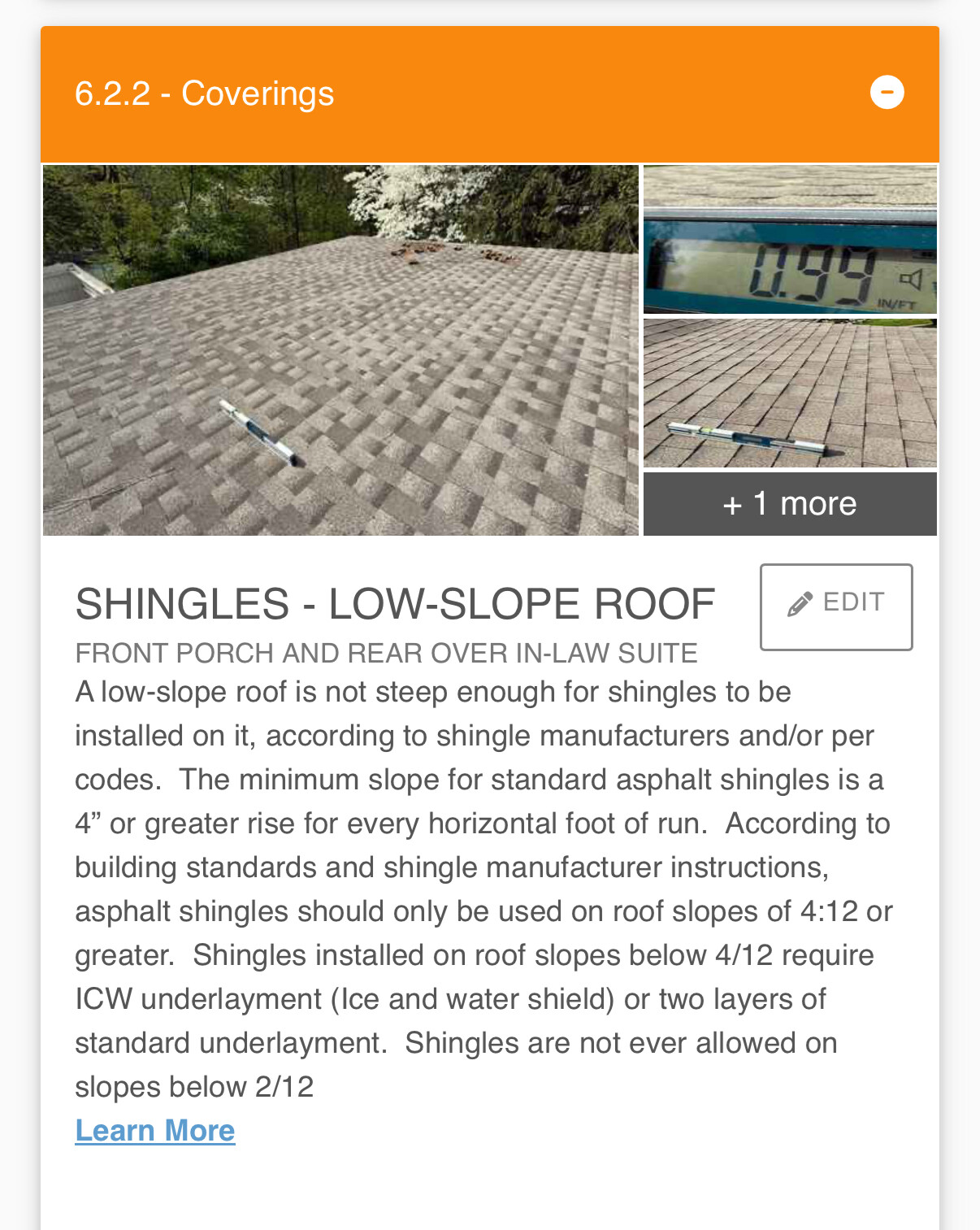

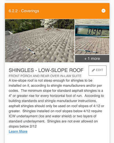

Here is one from last month I had that was slightly less than 1/12. It was 0.99/12.
