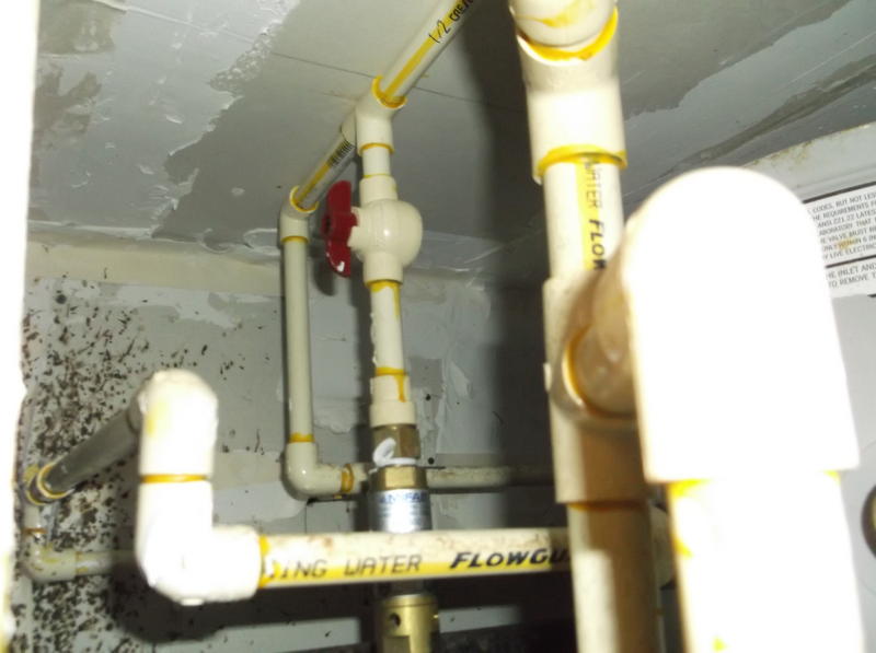

Not sure what the spots are on the wall and floor. The plumbing is for a small hot water heater that was built into a small “storage attic” built into the office space. This is the only location in the building where these marks were observed. They seemed like some sort of splatter mark, but I have not seen these marks before so I was hoping someone with more experience than I might enlighten me as to what they might be.

Looks like roach droppings.
I was thinking they were some sort of insect, but they were more of a liquid type spot and with it being on the wall as well as the flooring I was not sure. Appreciate the input.

Pests either roaches or cricket
Looks like roach droppings to me too. Was something up against the wall and then removed? I would also fire that drywall finisher…
Something splattered on the wall, look at the halo rings and the lines where some of it ran down the wall. No clue what, just comment and move on.

It is roaches as others have stated
what did it taste like? If it was sweet, maybe a 2 liter of pop exploded nearby. If it was bitter, it was probably roach s hit. :|.)

30 yrs in the remodeling business, I have seen this pattern many times usually inside the wall cavity up against the insulation kraft paper backing or back of drywall. It was always an infestation of roaches, specifically palmetto bugs. It appears that this is the same thing, only there must have been something propped up against the wall to create this kind of concentration. JMHO
