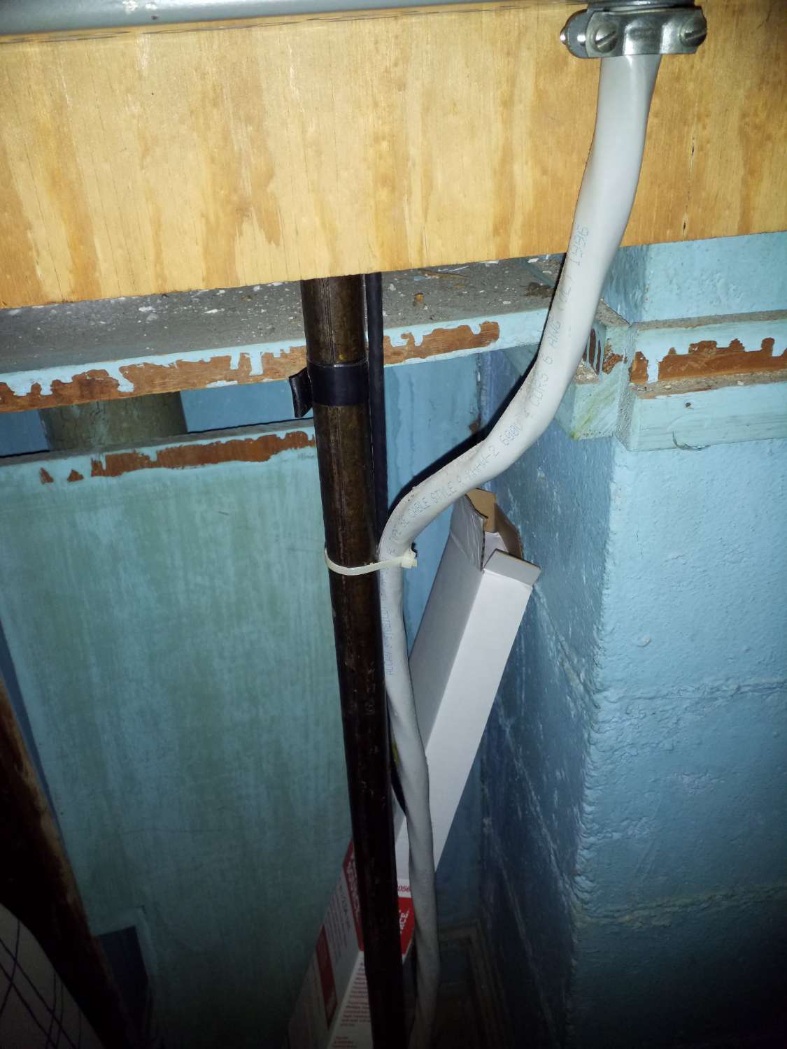

Sub-Panel line Zipped Tied to Gas line.
(Joshua LeBeau) #1
Gas line going from basement through 2nd floor closet to attic. Sub-panel feed is zipped tied to the gas pipe.
Is this an issue?
Thanks.

(David Wigger, CMI) #2
I found this from another forum.
Electrical wiring in contact with gas pipe, metal water pipe, and HVAC runs

(Robert Meier) #4
The issue is not the contact with the gas pipe it’s the fact that it’s not properly supported.
