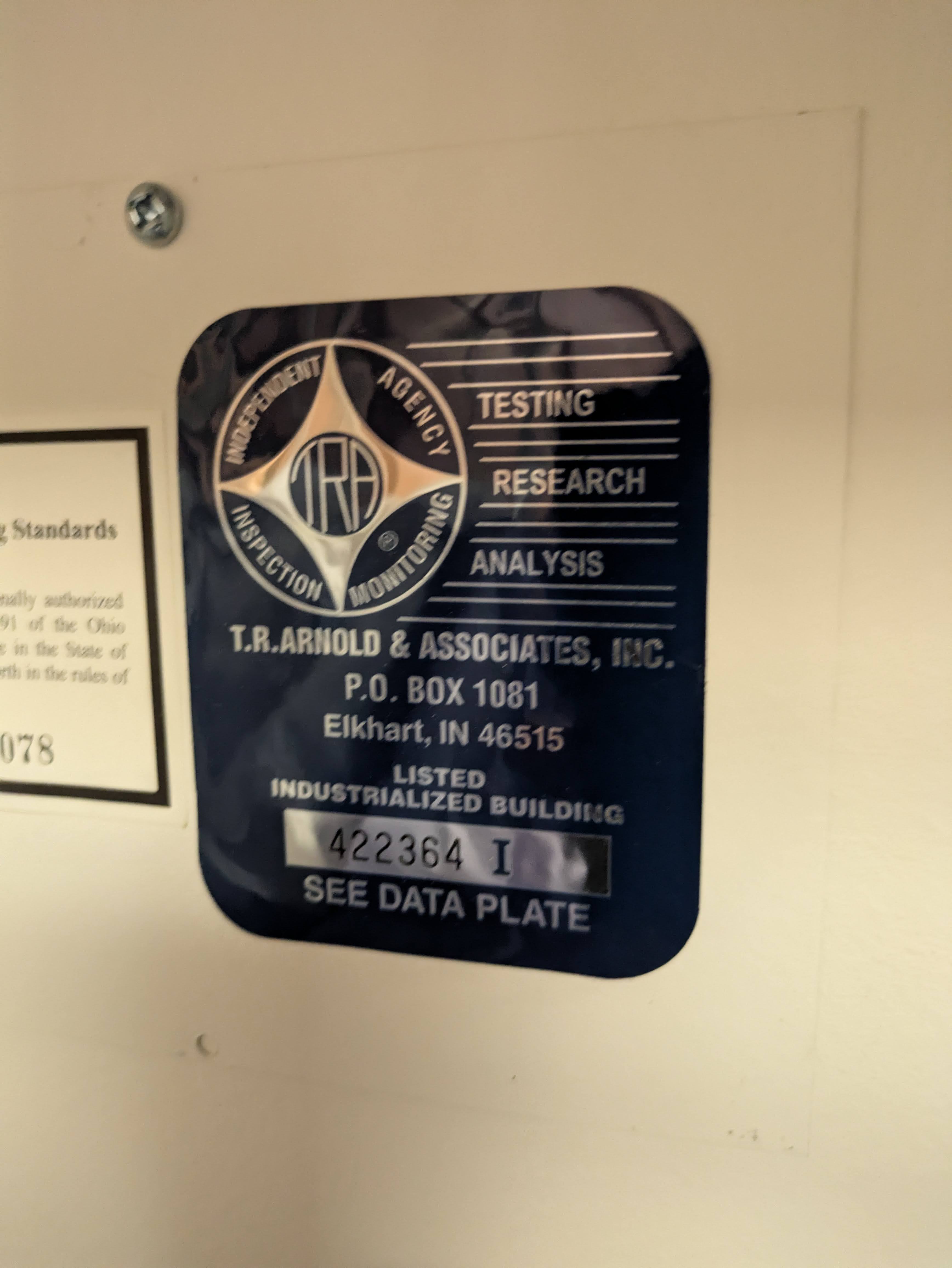

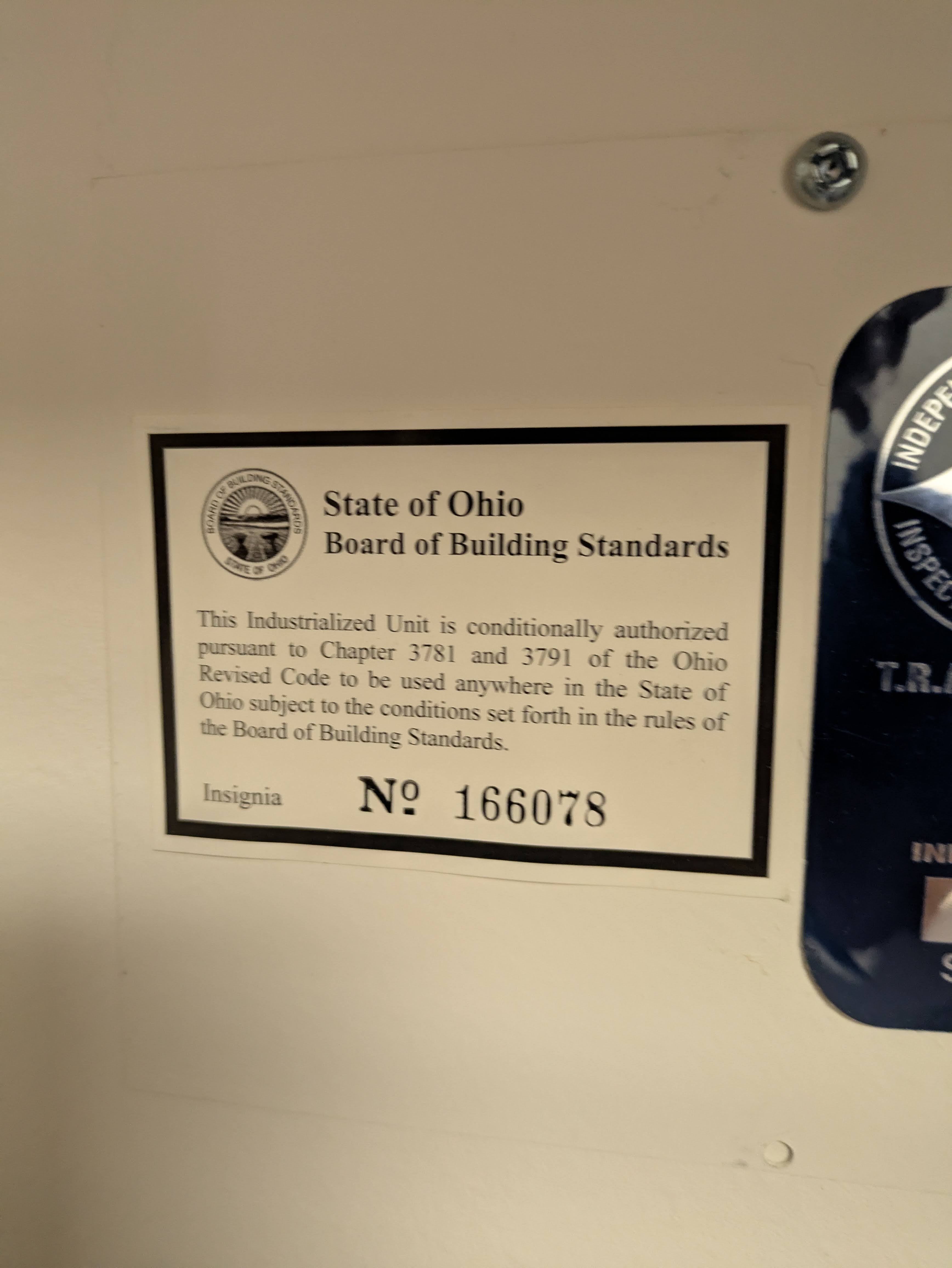

This was a commercial inspection of a manufactured building or “industrialized building” as labeled on the tagger. The rafter portion of the truss was a folding affair. Held together entirely by a metal joint on a bushing, it appeared.
My question is, once the roof was unfolded, should there have been braces put in, at least at the lower hinged portion (of the rafters … holding the roof) in moral support of those hinges? I would have, but I’ve been known to overcook an egg.
I have no reason to doubt this was executed as engineered/approved but just wondering what others think. I know none of us were there in Elkhart when the thing was whacked together.
