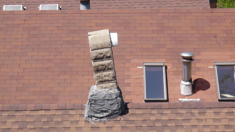

Doing a consultation on some water intrusion, and took a few pictures from the roof deck. It’s great what you can see when you take time and look.
- Nice tilting style chimney, complete with “Chicago Style” flashing (i.e., black roof dope, so named after the roofers who use it).
