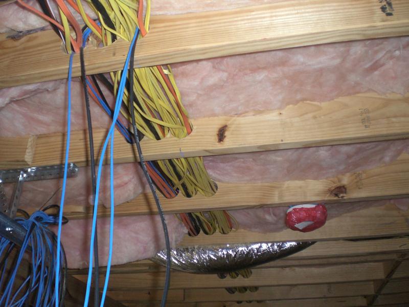

This just looks wrong
Comments please–
It looks like it may be short of at least 2" from the bottom of the holes to the bottom of the joist.
It does… just so many so close.
I don’t have the IRC handy here at the office, but I think the rule for holes requires the edge of any hole to be at least 2" from the edge of the framing member, and multiple holes need to be at least 1" of meat between them. They’re probably okay the 2" way, but they’re too close together. In my opinion, based on what I remember the IRC saying, each and every one of those joists has been ruined.
Pretty much each hole must be 2" from anything & nothing in the center 1/3:
Got to agree with Mark on this one. The structural strength is ruined.
I’ll agree with the others.

Thanks to each of you… I really need the help on this one, this is a builder that also teaches code at the local college.
Hey Mike- what’s the source on the attached jpeg?
John, to be honest I really don’t remember for sure but I suspect it is from “InterNachi’s mini-course tip of the day” on the bottom of the home page. Also see 2003 IRC R502.8.1
I just found it in 2006- thanks very much. You have all been very helpful.

Nice graphic to have.
Figure out the depth of the joist remaining above the holes. Now match this data against a joist span table that shows what size joist is needed to safely span that distance.
I will bet money that the two won’t match.

I was working in a house where the plumber’s drilled a 3" hole in the bottom chord of the trusses for a bundle of PEX to go almost end to end of the house. I tried to respectfully warn the plumber when I noticed what he was doing (he only had 2 done at the time). He looked at me like I was from Mars. Long story short, he drilled them all and the company he worked for (or maybe their insurance company) had to replace most of the trusses. The trusses with holes that were over a partition were allowed to remain with an engineered repair of some sort to the hole.

I’d red flag this if I were inspecting. It’s just wrong.
