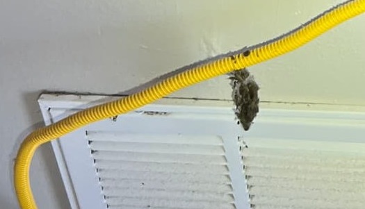

Unvented gas furnace near return
There is an invented gas furnace near a return vent. Is this an issue that should be noted/called out? I could see a potential issue if gas ever leaks at furnace and enters the system.
(I have disclosed the improper installation of the yellow gas connector running through wall).
TIA

As for CSST; did you look inside the return and inspect the pipe for fittings, or installation damage?
It needs to be secured to protect from damage (the return grill is blocked by the CSST which may result in damage from yanking on the pipe while opening the grill.

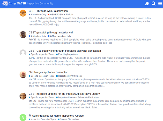

As for it passing through the wall, I recommend you look that up CSST installation for yourself. You will learn more about CSST more than just to this question…
Looks more like an appliance connector to me than it does CSST.

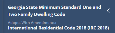

Not sure if it’s a local gas co requirement or building code but in Oregon you aren’t supposed to have any gas burner within 10 feet of a return duct opening.
Hey Matt, Hope you are well.
Is this what you are referring to?
My reference:
Yep… that’s it. I always remember it because one of my guys once missed it and I ended up refunding a fee. In his defense I don’t think I knew it until then. This was probably 15+ years ago. Like many things once I pay I tend to remember :slight_smile:

It still passes through the wall with no shutoff accessible though!
But but but we are not code inspectors!
Pulled out my telescope, looks like CSST. :wink:
Yes that is correct, but he said he had that part covered.
This is a case where the inspector does an inspection, calls things out, doesn’t know why they are calling it out, comes here for someone else to do their job. Responses are to make them “think”, not just get the answer. They should have access to the Code if they are going to report Code violations as they see them. Everyone else here posted copies of the information readily available on the net. There are also several archived threads on just these same issues here on NACHI. Just search for it, here or any search engine.
