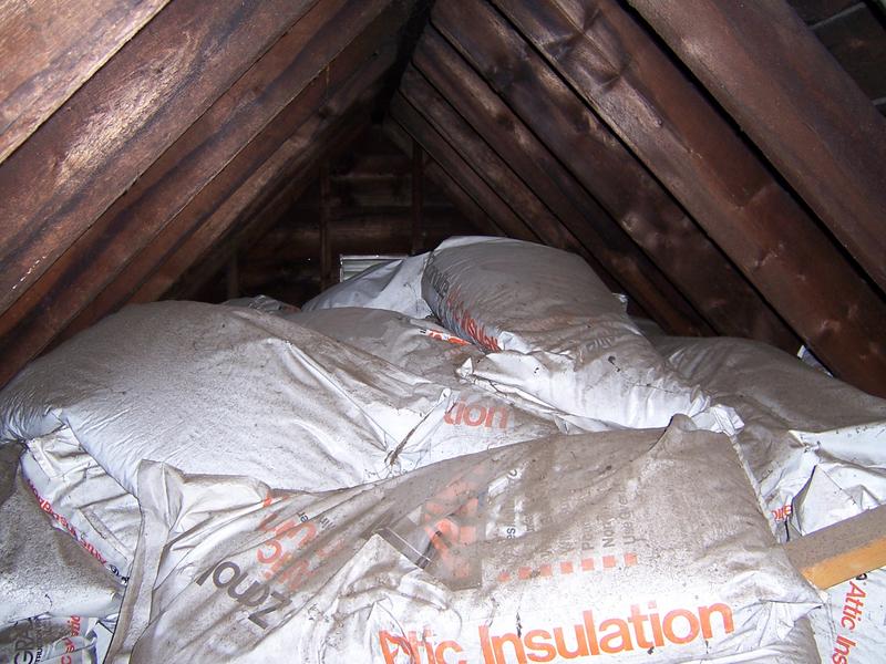

If you like the image with the bags of insulation in the attic, perhaps you’ll enjoy these images of an attic that I inspected that was loaded high with bags of vermiculite insulation…

What did you determine the R-Value to be??? :wink:
Remember that stuff very well. And hell, the insulation factor was there, just not very well distributed yet. :mrgreen:

So… is it a defect if found in attics???

Most of the Vermiculite came from the Libby mines. When I used the product as a young fellow, most if not all of the aesbestos content had been removed. Mid 1970’s.

My off the cuff guess was R-108 in places! :stuck_out_tongue:
I see vermiculite almost weekly in my area. Have delivered many a sample to the lab for testing. Very rarely find asbestos, but my clients feel better about it being in the attic.
You are being too serious Jeff.
I write up all Zonolite (Vermiculite). R-Value is not a factor.
