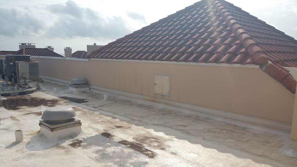

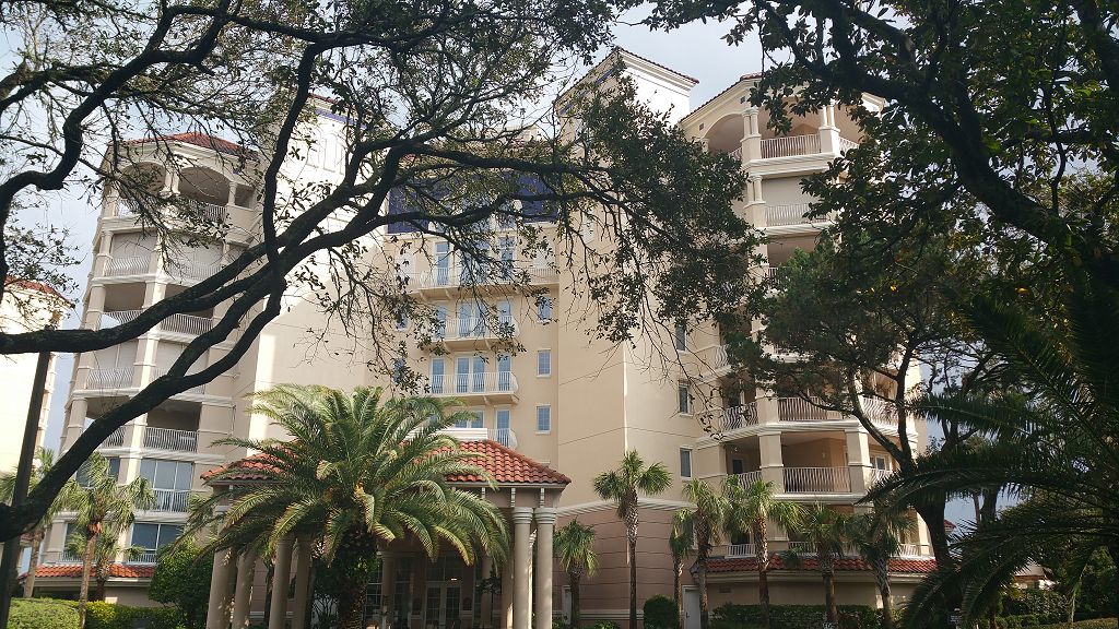

7 story condo building with a flat concrete roof, and ‘decorative’ clay tile roof built on trusses. (See pictures)
I marked it as
Roof Deck: Reinforced Concrete Roof Deck
Shape: Flat (the decorative clay is hip)
I got pictures of the clips and sheathing etc for just in case, but I’m thinking they are irrelevant?
Did I get it right?

110% correct!
I believe Roy is correct only a G.C. Architect or Engineer is going to be able to do it. what is under the hip roof shapes?
HIs do not qualify to fill out the MIT II/III form. Some insurance companies will take an 1802 FOR THE UNIT, not the building. The owner of the unit should simply ask the HOA for a copy of the MIT form(they will have it on file or the HOA insurance company). The 1802 should really be used to verify opening protection on a condo(although there is a form for that also). That is not to say some agents do not insist on an 1802 for the building.
That is a Type III building, built under the IBC standards. If this wind mitigation is for the HOA on the entire building, the MIT-BT II & III commercial form should be used. The minimum qualification for signing that form is a CBC division 1 contractor. If the inspection is for an individual unit owner, then the carriers are accepting the standard 1802 form.

Mike, it is a flat concrete roof under the clay tile structure.

Mike, these condos are on a private, fancy resort. So I guess they did that to make it look nice.
