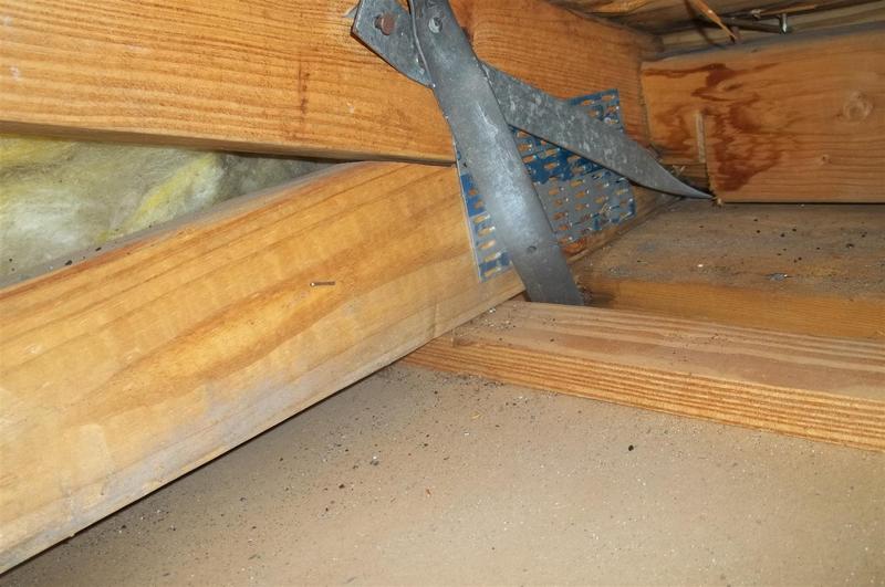

What type of roof to wall connection would this be classified as?
Hah, that’s a good one. I would go with toenail.
Minimal conditions to qualify for categories B, C, or D. All visible metal connectors are:
*Secured to truss/rafter with a minimum of three (3) nails, and
looks like each strap must have 3 nails or they don’t qualify at all.

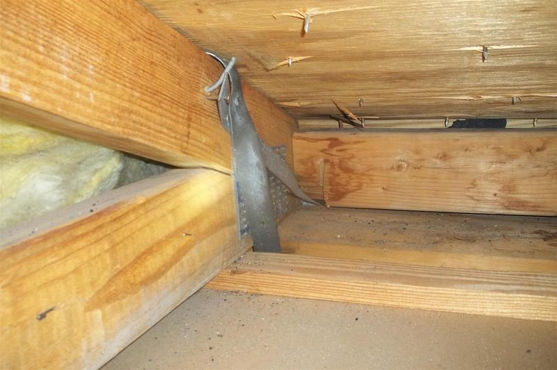

The opposing side photo is not of the same straps. Nailing pattern doesn’t match up. Insurance company might kick that back as well.
I was guessing that this is one continuous strap which wraps around the top plate of this framed wall. If that is the case, it is nailed with two nails on one side,one on the other, which would make it a single wrap. The fact that one nail isn’t all the way into the wood might be a problem though.
The opposing picture shows three nails from one side and one from the other side.
The question is, how is it attached to the top plate?
If all I saw was that I would say crap. Toenail/metal that meets no requirements.
I would bet that would be a reinspectors answer.
What will they think of next…Toe nail (ii). One end of strap (even if continuous) only has 2 nails.
A. Toe Nails
Truss/rafter anchored to top plate of wall using nails driven at an angle through the truss/rafter and attached to
the top plate of the wall, or

I’ll send the pictures to someone from Simpson and see if they have a spec sheet for it including installation.
No need to send to Simpson, that is not a recommended installation by anybody. It is also not attached to top plate…can’t even give it a clip rating. Toenail (ii), trust me.
It was a recommended installation by someone as it was installed in 1985, permitted and inspected.
How do you know it isn’t attached to the top plate?
I’m with Mike, if I saw that, I would say Crap, lol. I hate pulling that trigger too. I feel for ya Eric. Bearer of bad news just because the insurance industry wants everyone to fit into a nice box. I hope you find out better news.
I have no problem calling it a toe nail. With of course the exception, that it could be some sort of specific strap design that wraps around the top plate, is nailed with four nails to the plate, has at least three nails in the truss. In that event,it would be a single wrap.

Toe nails unless I can determine if there is a 3rd nail hidden by the second attachment. Observe that 3 bent over nails are seen in picture #3. You will have to get better pictures or your selling your client short.
This may very well turn out to qualify as a clip. I would need to see the back of the truss pictured in the other photos.
You couldn’t get the backside of the truss picture, but, you can see the nail coming through the wood, which looks like it pushed the strap out of the way as it was nailed.
“If” that is a single strap, and “if” it is secured to the top plate, it does have two nails on the front side of the truss, the form doesn’t specify where those nails have to be or where in the strap they have to be, and it does have one nail on the backside, then, according to the definition on the form, it would be a single wrap, because it goes over the truss.
I grabbed the strap and it didn’t move, but, that doesn’t mean it was nailed and, that, I couldn’t see.
And, when I blew up the picture, there are actually three nails on the front side. One is partially hidden by the wrap. That is why on the other picture of the backside, there are three nails coming through.

I could only get to two of them and that was no small feat! I would say that they are. I could see one other one which was the backside of a truss that had three nails coming through it. One of the pictures didn’t come out. ![]()
I am also going to guess that this, if I can get documentation, will qualify as a singe wrap.
